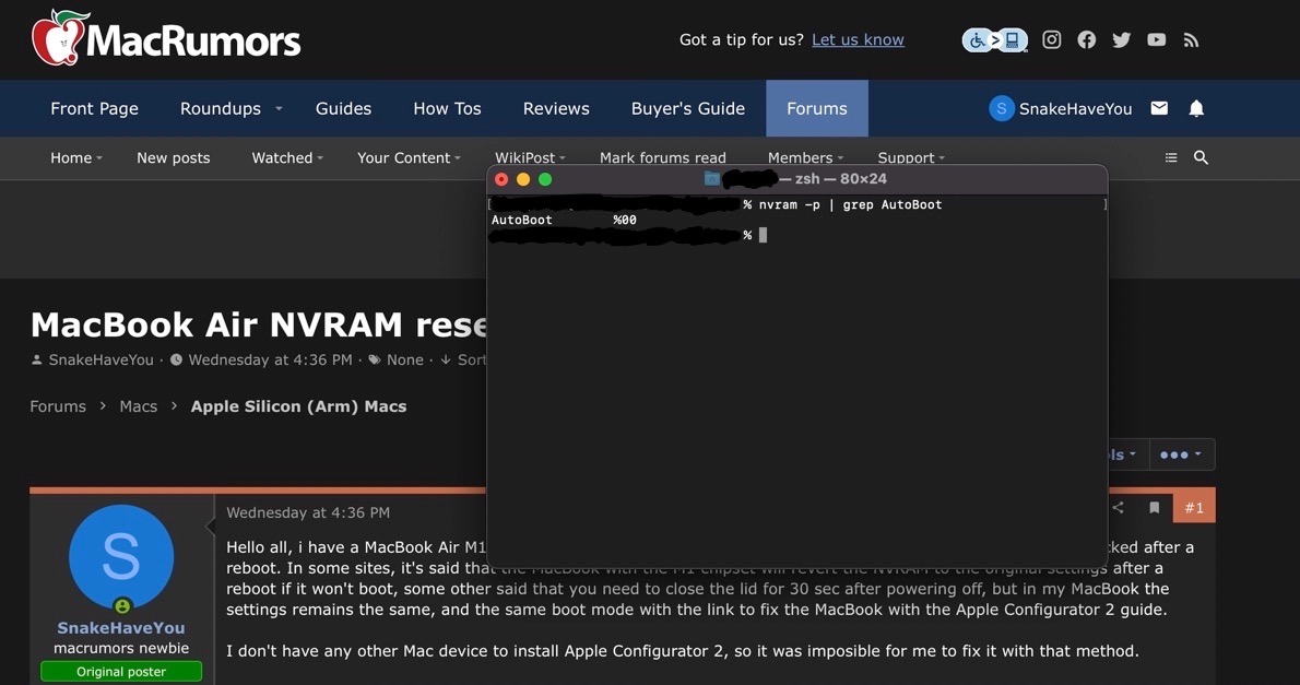

Hello all, i have a MacBook Air M1 with 256GB, and after modifying some NVRAM settings with Terminal, it got bricked after a reboot. In some sites, it's said that the MacBook with the M1 chipset will revert the NVRAM to the original settings after a reboot if it won't boot, some other said that you need to close the lid for 30 sec after powering off, but in my MacBook the settings remains the same, and the same boot mode with the link to fix the MacBook with the Apple Configurator 2 guide.

So after that, i booted my MacBook into the startup options boot mode, selected the Options menu and using the Terminal app from the Utilities menu, i modified back the NVRAM settings to default, rebooted and it worked.
So is there any way to reset the NVRAM settings with the M1 chipset?

My MacBook didn't reset the NVRAM settings by itself. After modifying NVRAM settings, i turned it off, and after powering up, the MacBook was unbootable. After that, i turned it off pressing the power button, keep the lid close, and after that, it was unbootable.
I configured again the NVRAM from Terminal because i knew what settings i've modified, so i modified those settings again.

I don't know, the other setting i've modified or added is still there: AutoBoot
And i don't know if that setting is on the default NVRAM config.

I configured again a boolean setting on the NVRAM, not with "nvram -c". With "nvram -p" the setting i've modified was still there.

Well i tried to turn off the MacBook, using the power button, and keep it off for more than that, with the lid close, and after that, it was still unbootable to the OS.
I could reset the NVRAM settings not by setting to default, but by changing again the "Auto-Boot" boolean variable i've modified manually.

There is an "Auto-Boot" setting, that's the variable i've modified and after that, the MacBook was unable to boot to the OS.

I could try to modify again the "Auto-Boot" setting to test if the NVRAM settings resets after a power off, but i don't have any other Mac device to restore it if i can't enter to Terminal again.

It was the same setting i’ve modified, “Auto-Boot” has a boolean value, the default in my MacBook is “true”, i modified to “false” because using “AutoBoot=%00” didn’t disable the power on while opening the lid, so i tried “Auto-Boot” to “false”.
But that screenshot is showing that “AutoBoot=%00” didn’t revert to its original value after a reboot o power off.
Also “Auto-Boot” and “AutoBoot” seems to be for different things or architecture, because the guides that says you can modify “AutoBoot” probably are for Intel based products.
