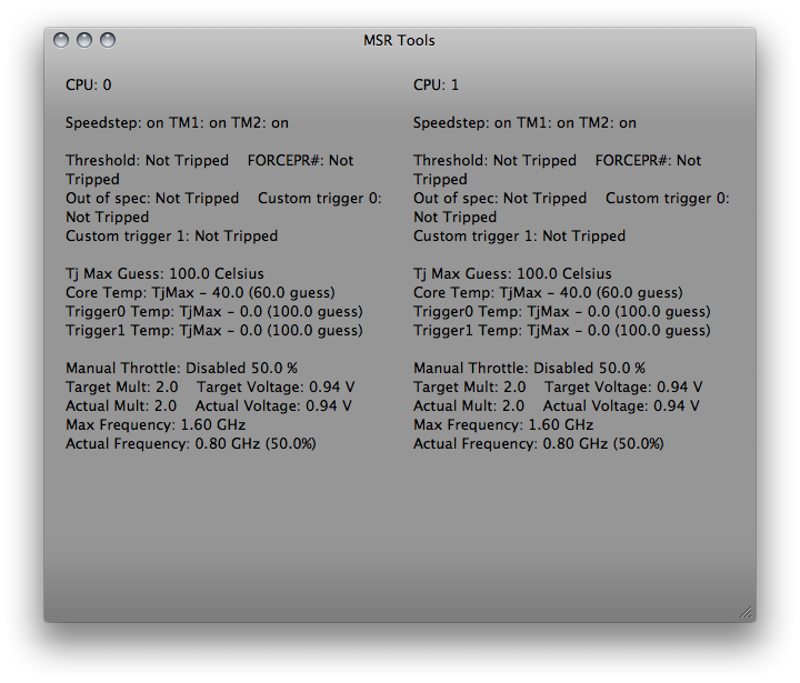

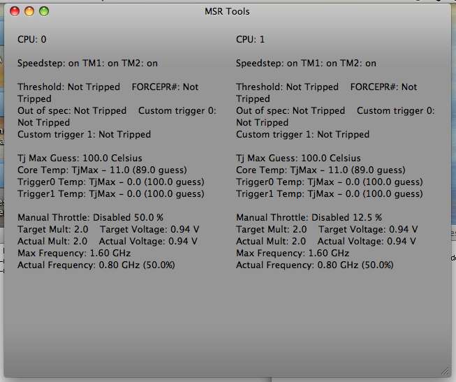

Hi Guys,
FYI, I have a MacBook Air 1.6/80HDD. Running some scientific calcs in Win32 app under Parallels and XP (installed on the Boot Camp partition).
As an aside, prior to the MBA-specific Parallels patch mentioned above, I had loads of (maybe 100?!) kernel panics. Are there others here who are now able to say 'You must now restart your computer.' in 5 different languages? These forced me to restart both the Mac and XP every time. Not my idea of fun. But I thought my troubles were gone with the Parallels patch (once I was finally able to track it down).
Now I have the overheating issue. The MBA runs for five seconds (ish), freezes for seven (ish, it's not consistent), and my calculations now seem to be taking MANY times longer than they should.
It's intensely frustrating.
Running MSR tools shows the temp going over 90 deg, and both cores dropping to 0.8GHz (is that a record so far on this Forum?!) and that's even BEFORE the machine gets hot enough to start freezing!
So even when the machine appears to be running properly, I guess I'm probably only getting 50% of the performance I expect. Factoring in the freezes, I guess that means my calc is probably running about 20% of the speed it should be (and that feels about right).
FYI, I'm seeing the 0.8GHz with the machine very carefully elevated on a Griffin iCurve, and placed in the coolest part of our house!
Not a happy bunny...
Phil
Marlow, UK

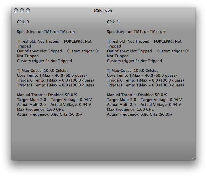

I'm using CoolBook to run my MBA at 800Mhz permanently. I was running 2x yes > /dev/null. In normal use the temp is generally less than 45C.
I code on the air and send all the heavy processing to a pair of Xserves so 800Mhz is more than enough. In fact, I couldn't really tell the difference between 800Mhz and 1.6Ghz.
