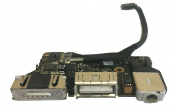

Is it possible that there is a problem with the MagSafe I/O board?
There could be, but it's not a separate board on the Air that I know of. It's all one board. No way to test without spending a lot on a new board.
It is a separate board. The I/O board from a mid-2013 to 2017 will work.

Although the 2012 board looks similar, the WiFi card is rotated 180 degrees and the camera cable on the 2013-2017 is right beside the logic board connector for the I/O magsafe board. For the 2012, the camera cable connects to the Magsafe I/O board.
