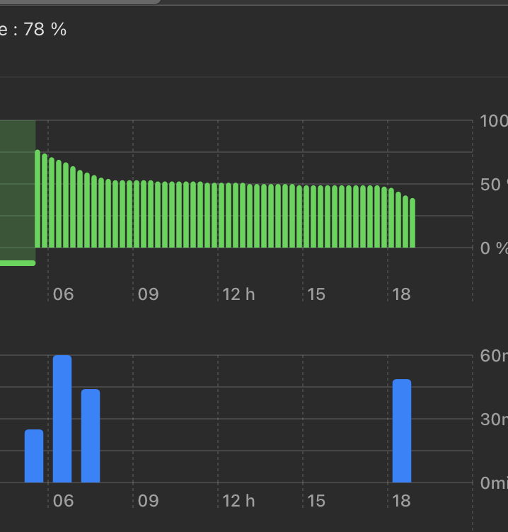

the battery dropped from 78 to 26 in less than 3h today , chrome, pixelmator , documents , nothing crazy

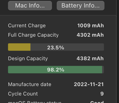

apple says it's good , system reports 100% of health , but coconut already shows 98% after only 8 cycles ...
"MaxCapacity" = 100
| | | | | "DesignCapacity" = 4382
| | | | | "AppleRawMaxCapacity" = 4298

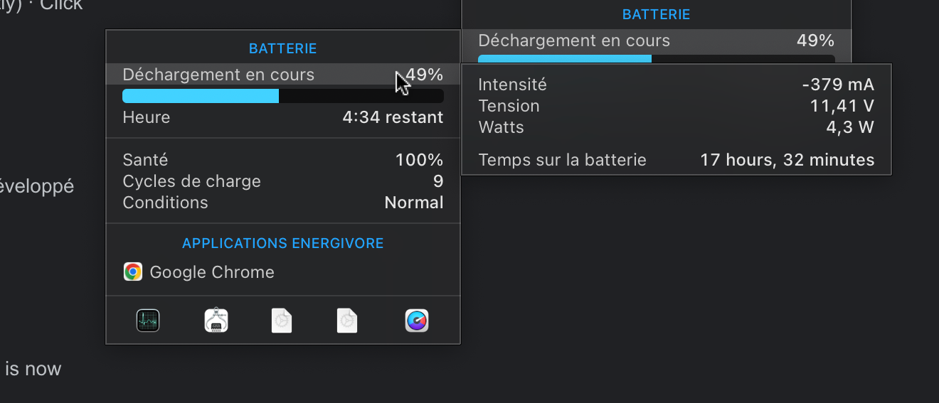

Battery life depends on the workload in terms power consumption in watt. M1 MBA battery size is 49.9 watt-hour so if you're getting 5 hours then your workload is pulling about 9.98 watt (battery size in watt-hour / load in watt = battery life in hour) and I've seen it close to 20 watt under load. Suggest using an app to log over time powermetrics power consumption, running processes and utilization, battery life, etc. so you have better visibility into what's causing it. Look into iStat, iStatistica, etc.

macOS versions weren't the same , one was on 13.0.1 and the other is 13.1 . here is a link to how quickly the battery is discharging if you understand how to interpret it
looked into istats but not sure what it means...could u enlighten me about these numbers ?

Chrome isn't the issue since I have 29 charge cycles over two years. It would be a lot more if it was the cause. If you're running Adguard app it's known to cause battery drain. Suggest trying Chrome+uBlock Origin extension which is what I use or Chrome+Adguard extension (not app) to see if battery life improves.
