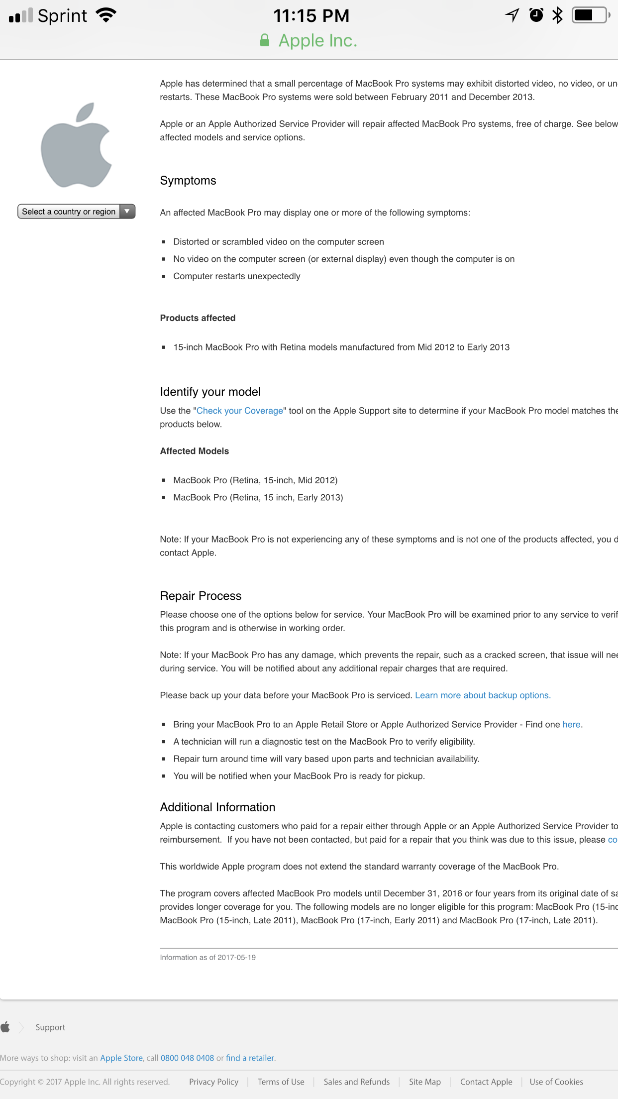

[doublepost=1509423008][/doublepost]I too had this issue and found the answer. If your MacBook falls in this time segment they will fix it at no cost. It is apparently a recall. Best news I had gotten in the midst of trying to fix it.
