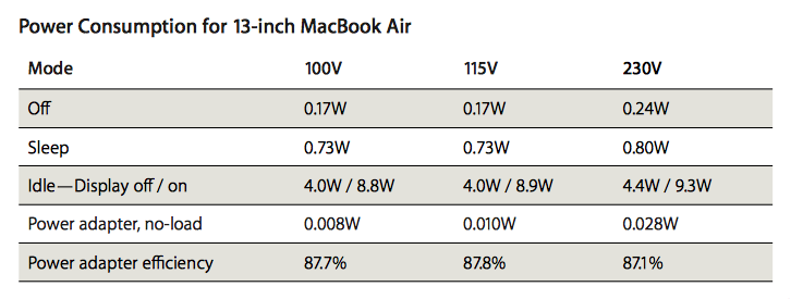

What you want is what Apple calls the "Environmental Report" for that model. That will show the power usage. I can't find one for that older model, but this report for a 2012 model Air shows about nine watts. I would not think yours would be much different.

(diagram copied below)
screen-shot-2016-10-05-at-10-16-51-am-png.663173
I don't quite understand these figures.
- Why is there power consumption when the laptop is off?
- Why does the power consumption vary with the wall voltage?
- Why does the power consumption increase at the same time as the 'Power adapter efficiency' figure increases? (I would expect to see an inverse relationship between adapter efficiency and power consumption.)
I think it is like those wall wart DC adaptors you have around the house for different gadgets.... even though nothing is attached to the wall adaptor it uses a little power for its own circuitry.
On the other two... I don't know, but it is pretty close in both measurements across the different voltage levels.
Don't take my word on any of this, but I think:
- It could be that even if the MacBook Air is asleep, the AC utility power will go into the transformer (MagSafe) and just back out again as it's not needed, maybe?
- There is True Power and Apparent Power and those vary depending on the efficiency of the device they're powering. It could be an efficiency issue? The rating shows that around 13% is being lost to harmonic current.
- To make up for a loss in amperage the utility will compensate by upping either the voltage or current to fill the gap in power distribution, maybe it's an efficiency issue again?
Like I said, I'm not sure, but it's my guess from the research I've been doing.
