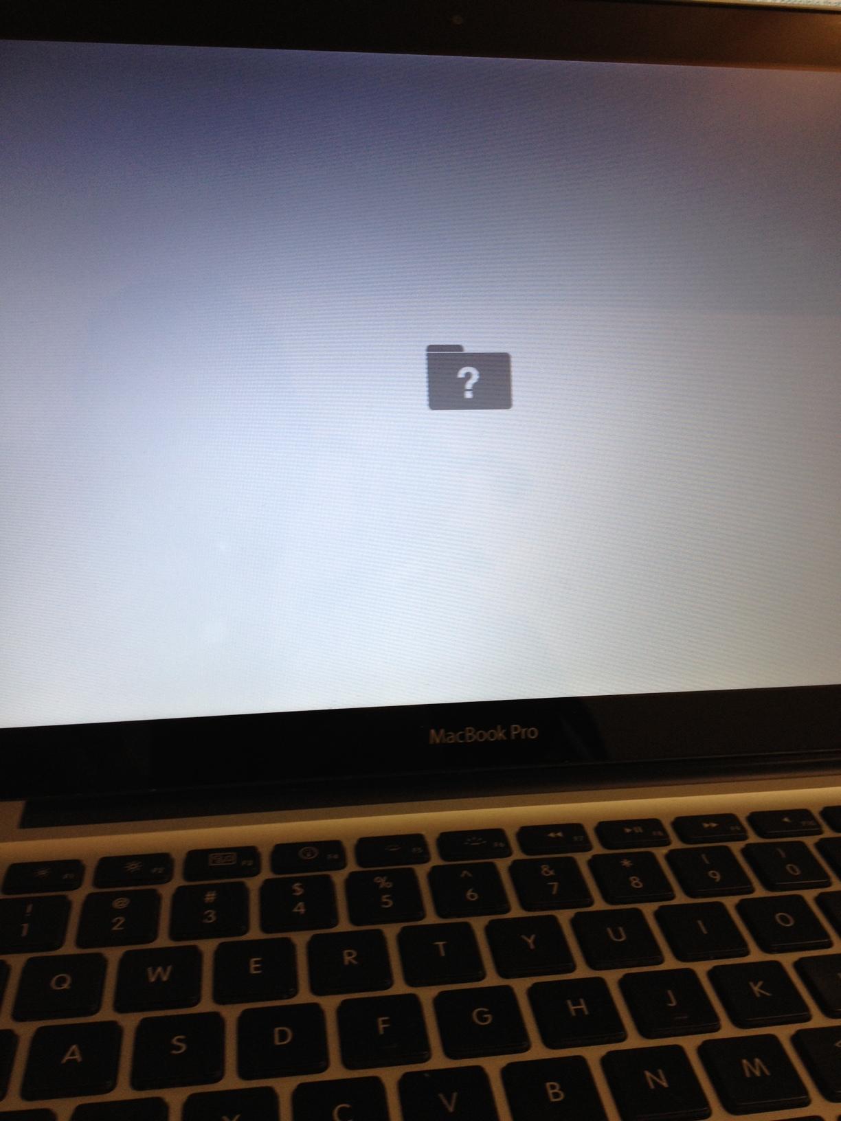

Hello,
A friend of mine gave me his mac, with this problem.
First thing i've tried, is to boot up a live ubuntu, to save all the personal files.
But i couldn't find the ssd.
All i've got is this image.
(in spanish)
is the ssd dead ?
thanks.

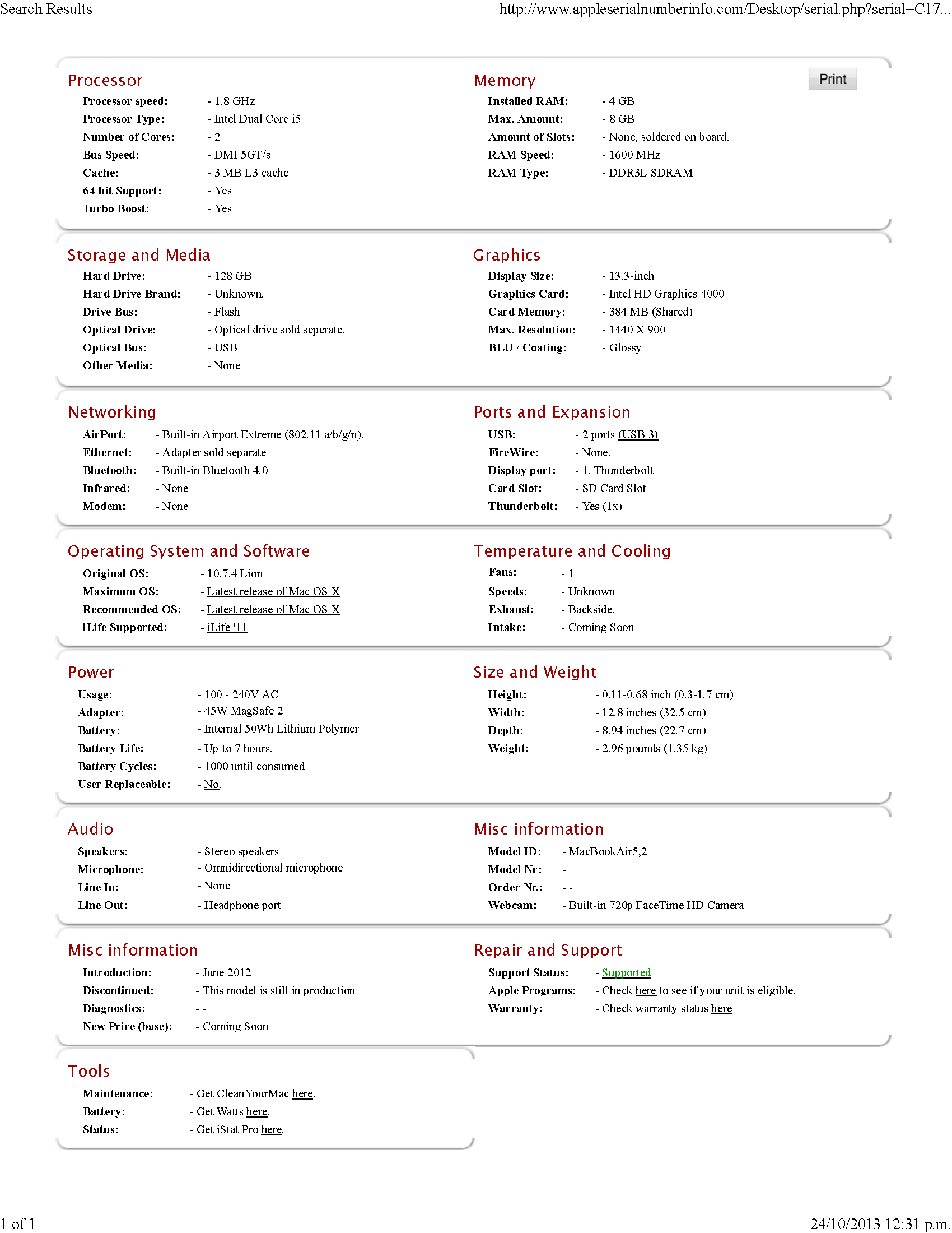

Is it the 2012 model? The SSD is probably dead, but Apple is replacing them for free if they're covered under the replacement program.
If it's a 2012 with what was supposed to be a 128GB SSD, then it's affected by this issue:
http://www.apple.com/support/macbookair-flashdrive/
You should be able to take this to an authorized Apple repair center for replacement, through these things are failing like crazy right now, and with the replacement program in full force, supplies of new SSDs are constrained. So, it could be a bit of a wait.
Unfortunately, the data on the drive is a lost cause, unless he has a backup.

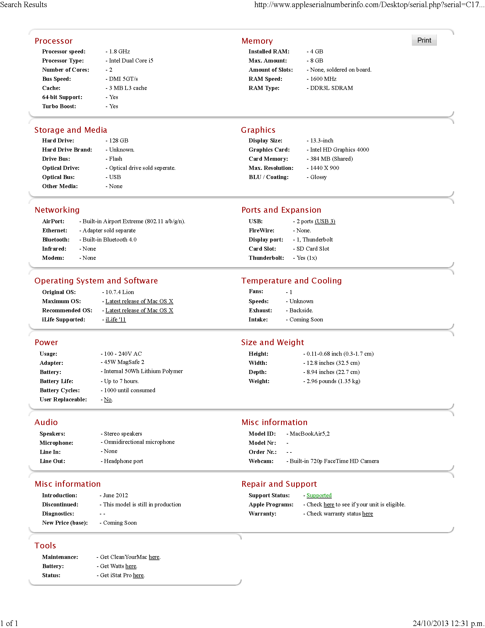

is there a way to know 100% that the sdd is dead ?
this is the macbook

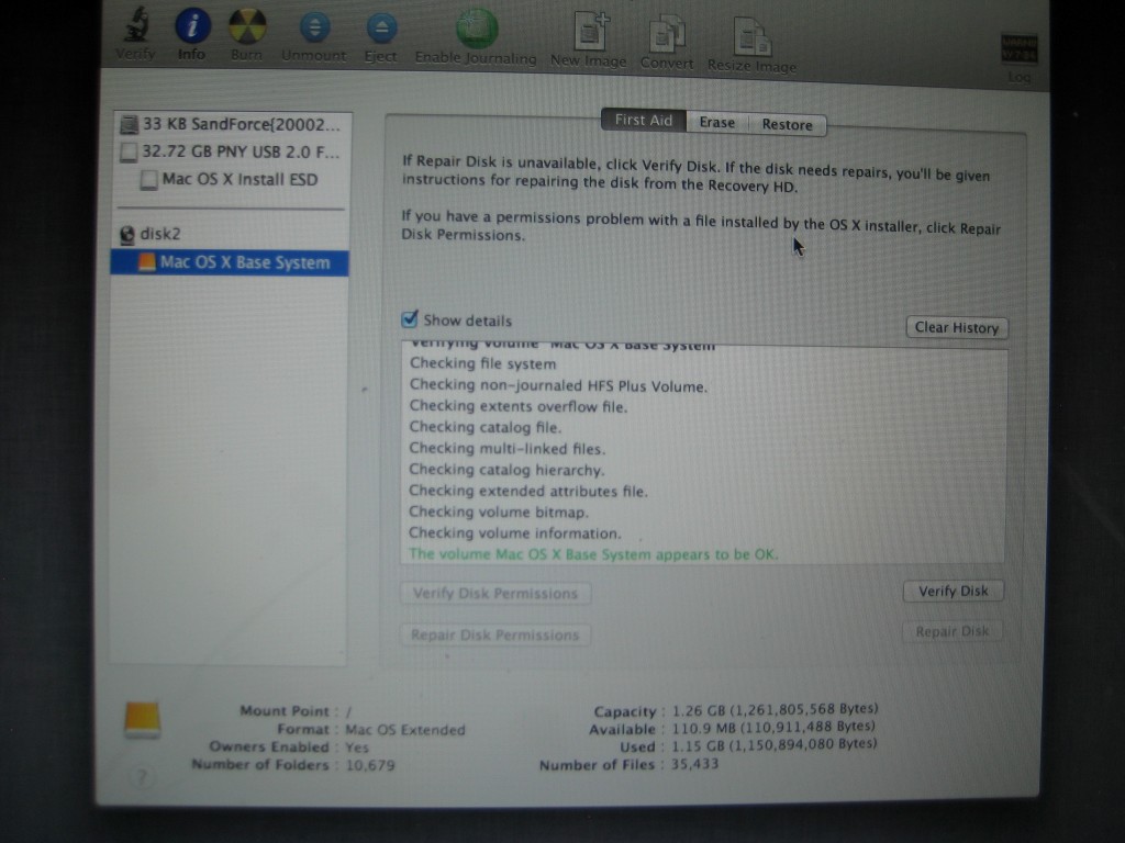

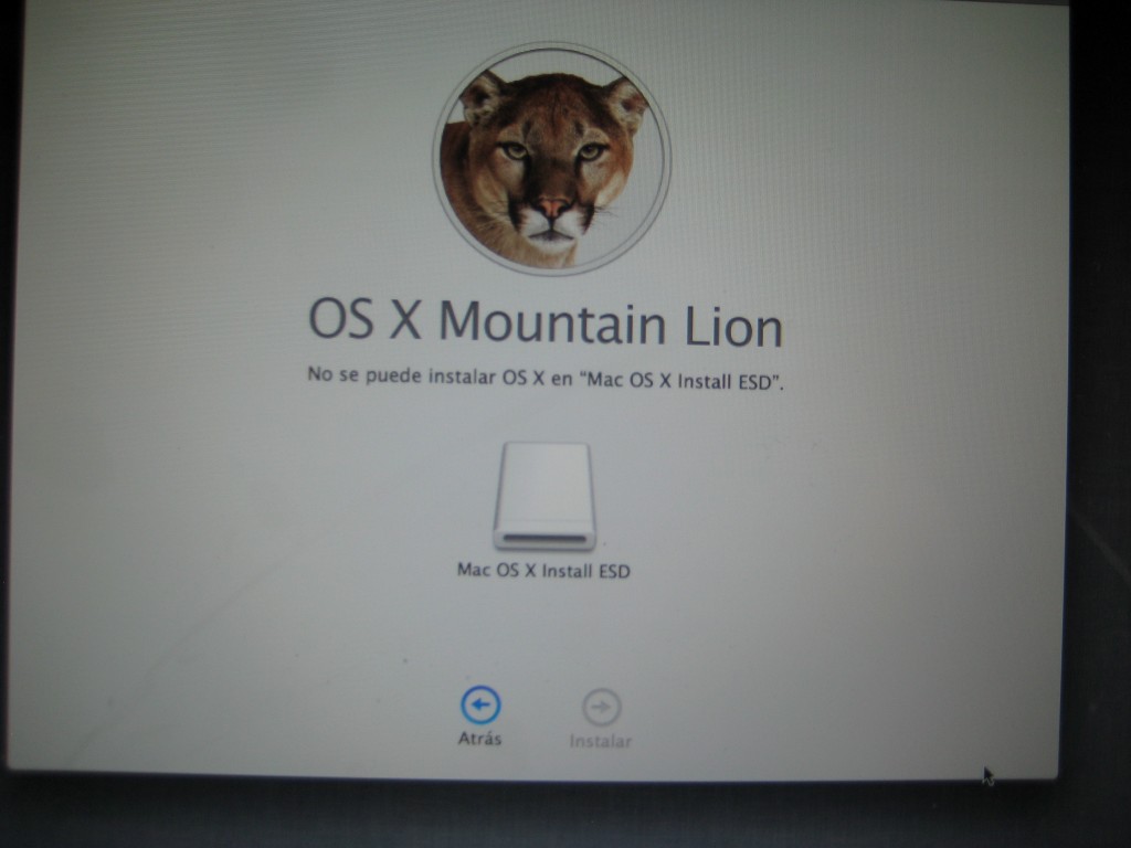

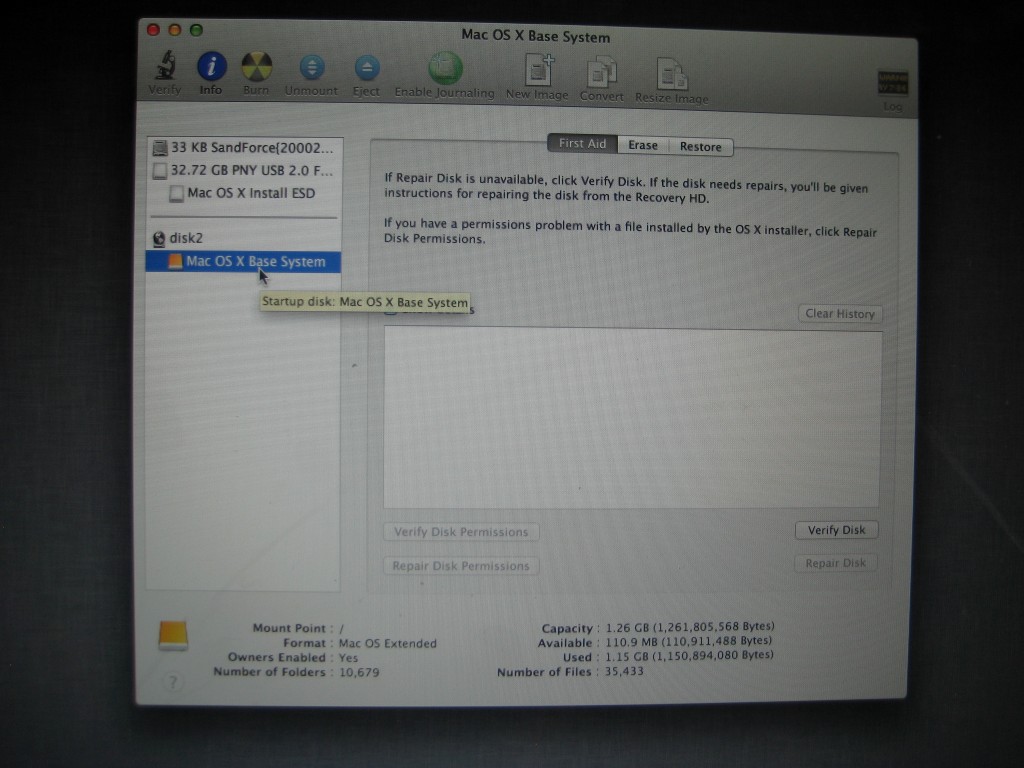

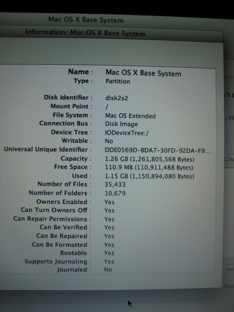

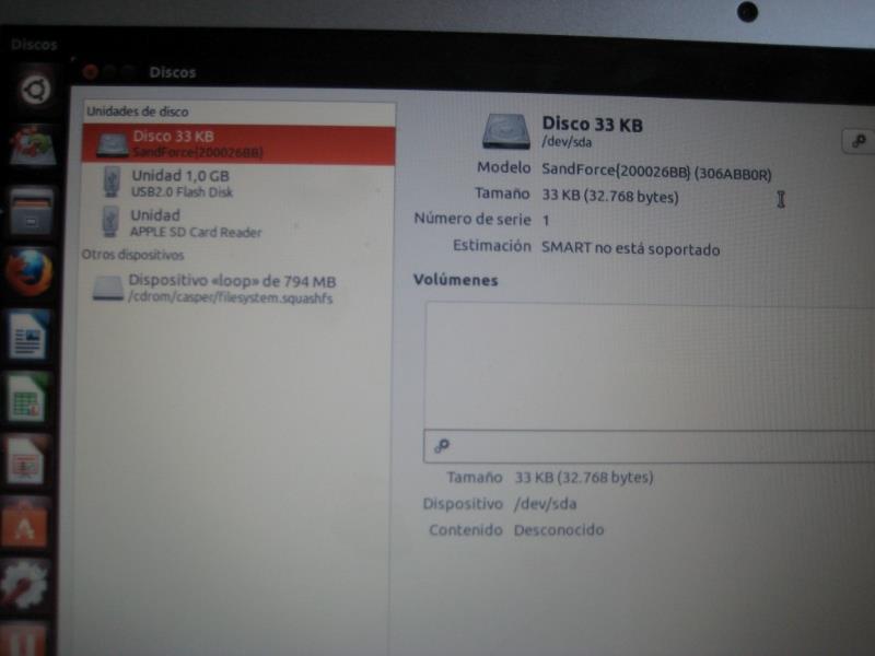

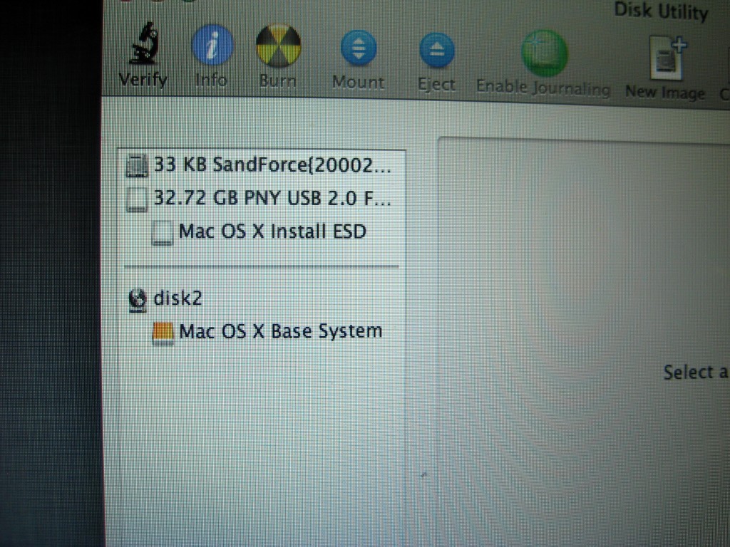

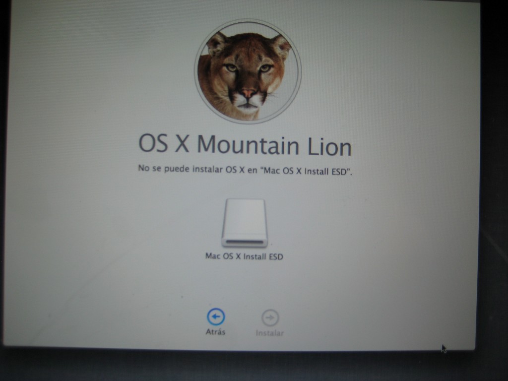

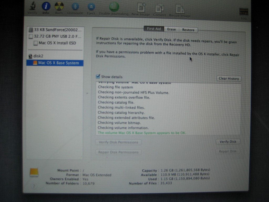

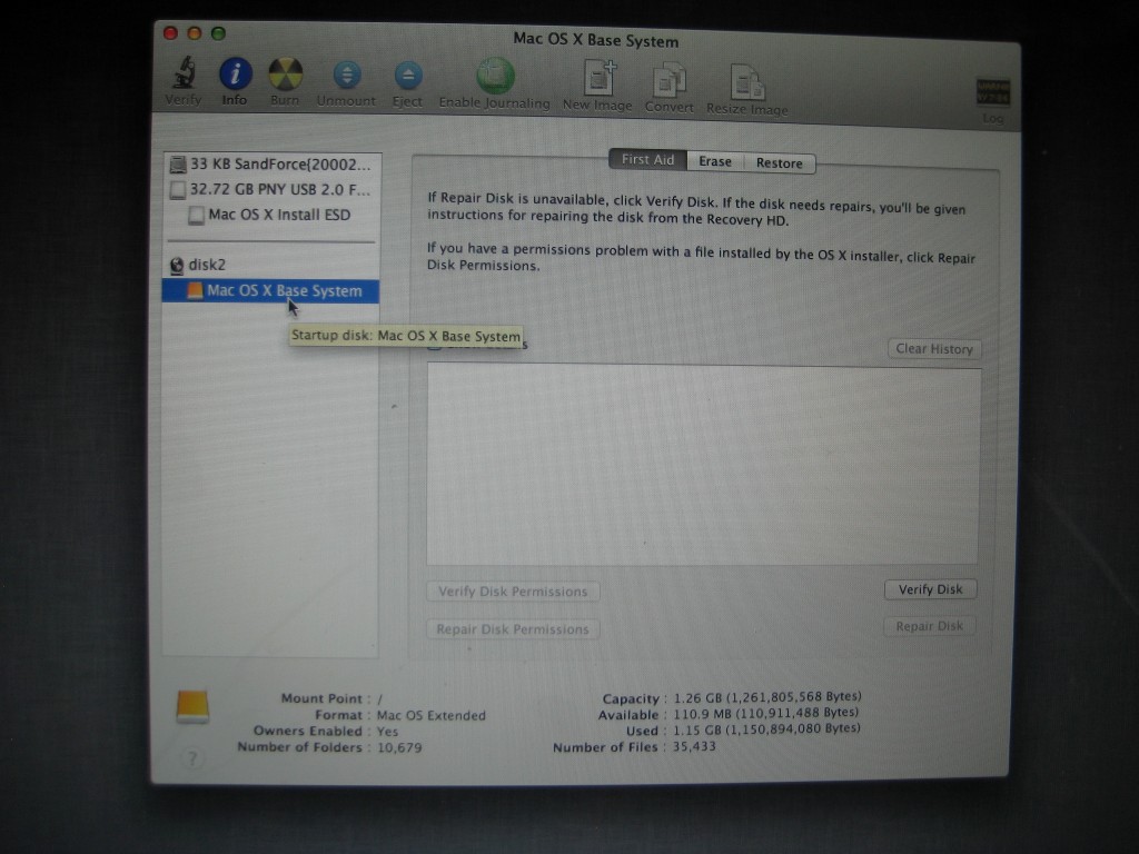

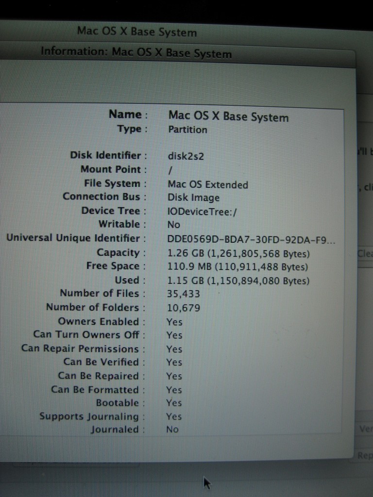

a few more pics to confirm any kind of info.
is it dead or not ? i can see it in there.

Your SSD is showing up as a 32KB drive. This is one of the signs of SSD failure related to the Toshiba SSD recall.
