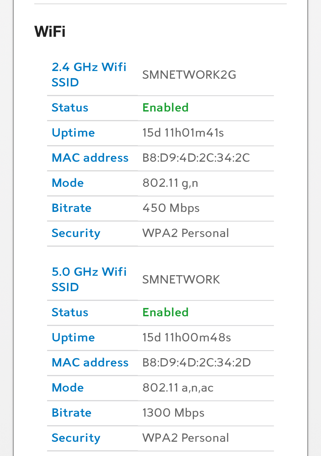

Hey guys my wife’s 2013 MacBook Air will not connect to the wi-fi in our apartment. I have spectrum with their provided router and basic settings. I’ve tried with 5ghz and 2.5ghz..... now here is where it gets weird, the WiFi works fine on my 2017 12” macbook, both our iPhones and her iPad Air. To make matters even weirder the MacBook Air works perfectly fine in our house where we have Verizon Fios. Anything I can do to troubleshoot this? Or am I just missing a setting or something
I added some screenshots of the router settings
*edit* also worth mentioning I did a clean install of High Sierra last night and set the computer up as new but the problem persisted.

You might need to delve deeper into the router settings for the troublesome network. See if anything looks unusual.
Nothing you described sounds like there should be an issue.
What happens, exactly, when you try to join that apartment wifi?
One thought is to make sure that the DHCP pool is large enough on the router. Otherwise, the router will not be able to hand out an IP and other information to the laptop. Depending on the router, look for a setting that says "DHCP" and has a starting and ending number for the pool. Increase the end number to something higher than it is but less that 255.
The network comes up on the list of available networks and i select it, enter the password. The WiFi bars fill up as if I’m connected but when I try to load a webpage or anything I get an error saying I’m not connected to the internet
