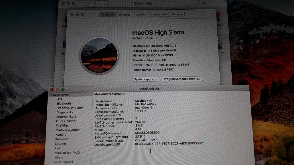

I'm thinking there is som problem with the SMC, i tried to do a SMC reset buy pressing the buttons, but dont get any green flash on the charger light so not sure if it actually reset?
Any tips here?? Is there a way to flash, update or reset the SMC on macOS?
Model: A1466
SMC: 2.13f15

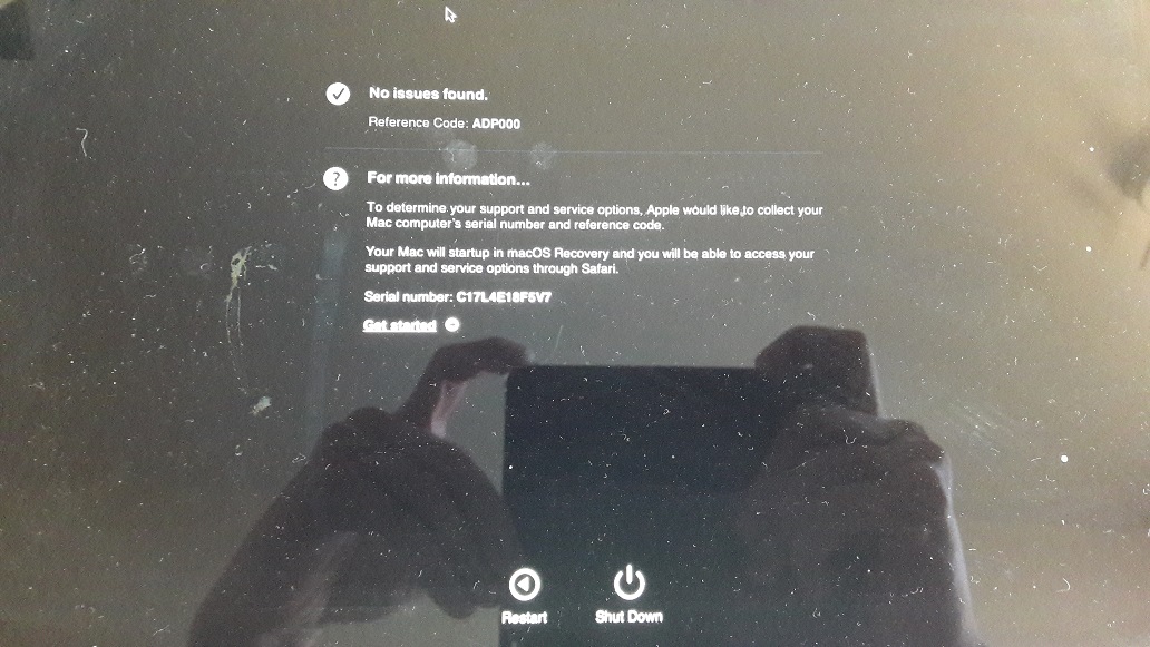

If the macbook runs out of battery or get "shut down" i need to open it and unplug battery and disconnect and connect charger to get it alive again. I run diagnostics (keep D when restart) and it did not find any error.

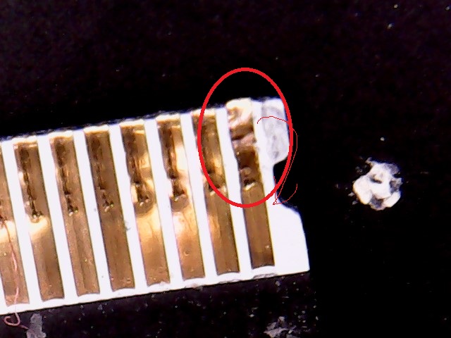

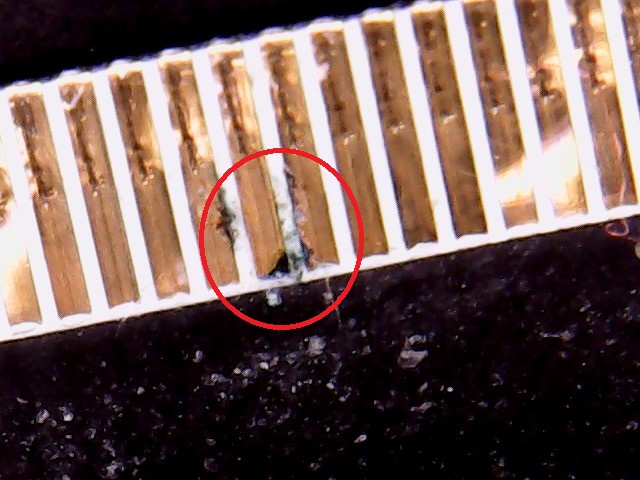

I disconnected the keyboard/trackpad cable and i noticed something looked strange. So i fired up my $15 usb ebay microscope and saw one of the pins was bended back, and 2 others looked like the had some corrosion or something maybe bridged them. I bend the pin back and cleaned up and made sure it was connected well. And then the Air started right up like everything was normal😎
So looks like the pin was for the power on/off key and it all this make sence now.. Thats why i could not reset the SMC too..

The power button circuit actually runs through the keyboard which runs through the trackpad.
The corrosion may be due to moisture exposure.
