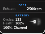

not sure what happens but all of a sudden the battery meter shows 10:00 of battery life. furthermore, istat shows 100% battery health. i'm pretty sure it's wrong because my battery health used to be about 91% (and of course we all know it won't last for 10 hours!) is it about time to replace my battery??

try resetting your SMC..
does everything look ok under system profiler>power?
what is your full charge capacity? between 4000-5000 mAh?
and it never hurts to reset your PRAM ;D

hi guys, thx for the suggestions. the info below is from my system profile:
Charge Information:
Charge remaining (mAh): 4097
Fully charged: No
Charging: No
Full charge capacity (mAh): 4769
Health Information:
Cycle count: 134
Condition: Good
looks ok right?
and no i'm still running leopard. now the battery indicator is back to normal....very strange indeed! i will keep an eye on it.
