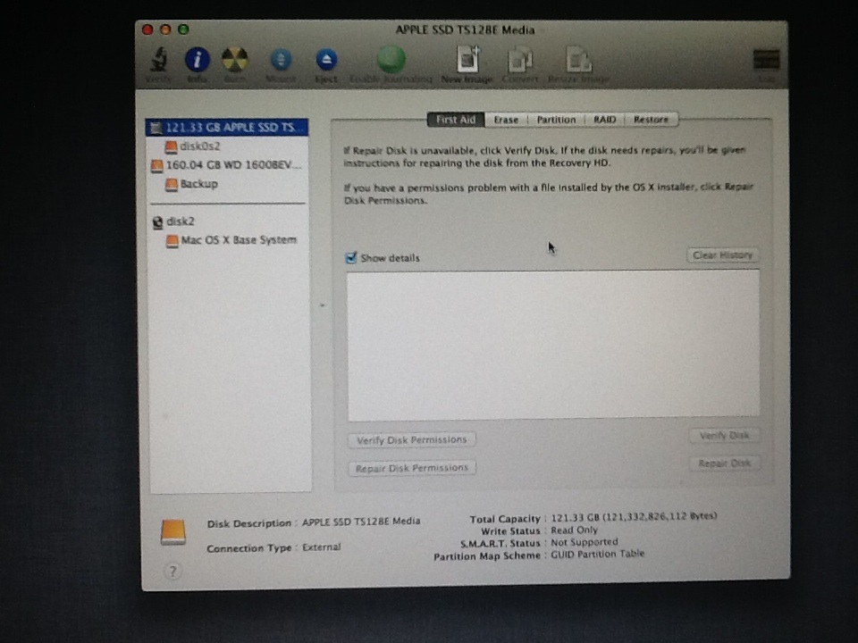

But when I try to restore the system (reinstall and/or from time machine) the system isn't able to see the internal SSD. And the disc utility shows it as an external drive which I can't delete, verify, or do anything else with it.
Verifying or repairing won't work

Yes, I tried it already. Hardware seems okay.
I also managed to fix the problem that the SSD was shown as an external SSD instead internal.
The SSD itself also seems alright in disc utility, so does the partition.
But every time I'm trying to reinstall OSX, an error message shows up that an error occured, and OSX couldn't be installed.
I already tried SMC, PRAM, Disc Verify, Disc Repair, and setting up a new partition.
