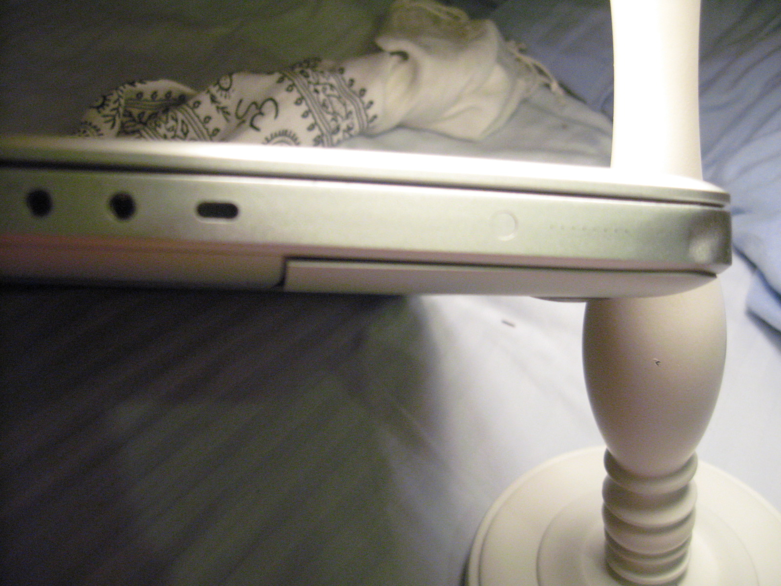

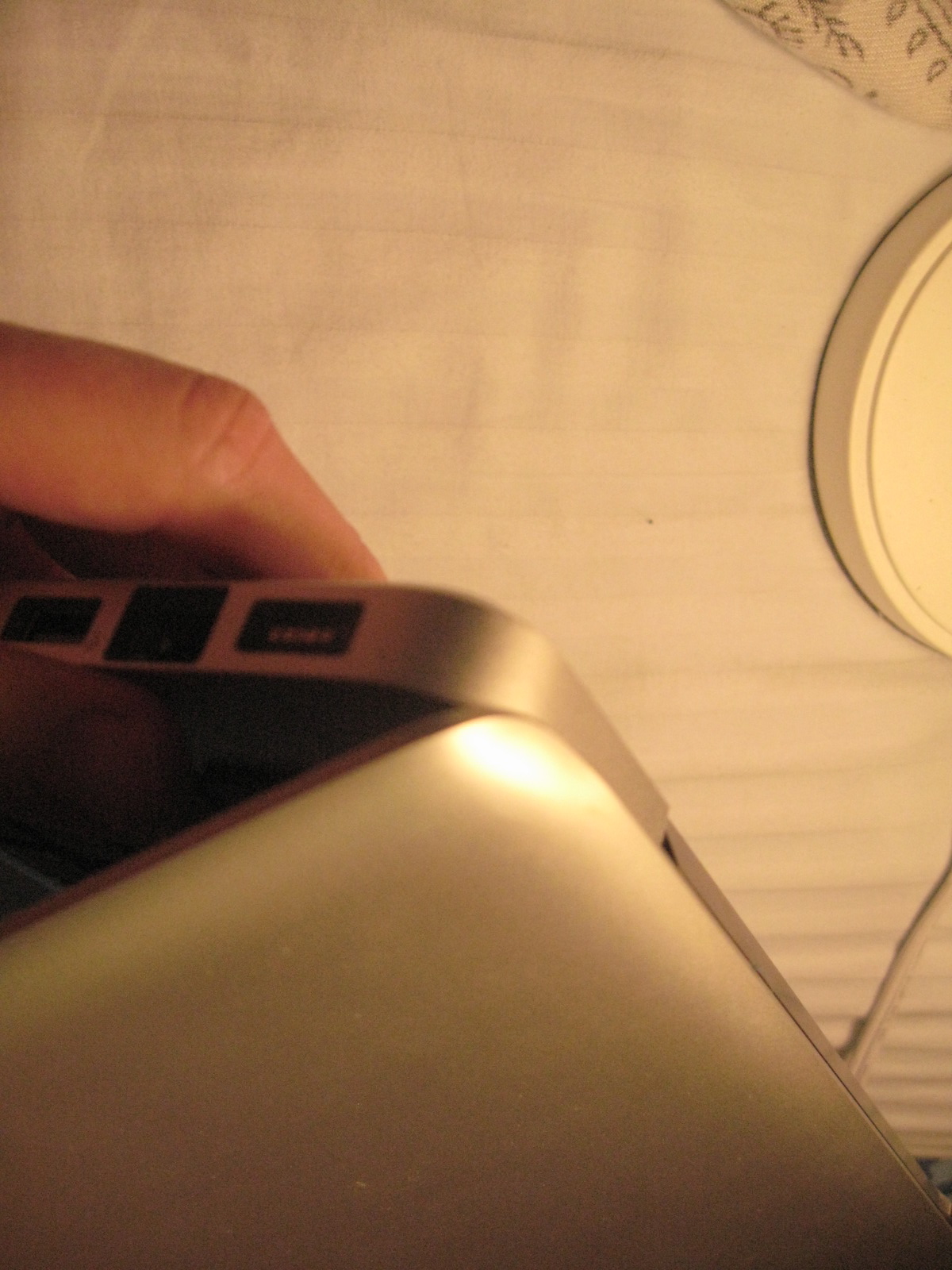

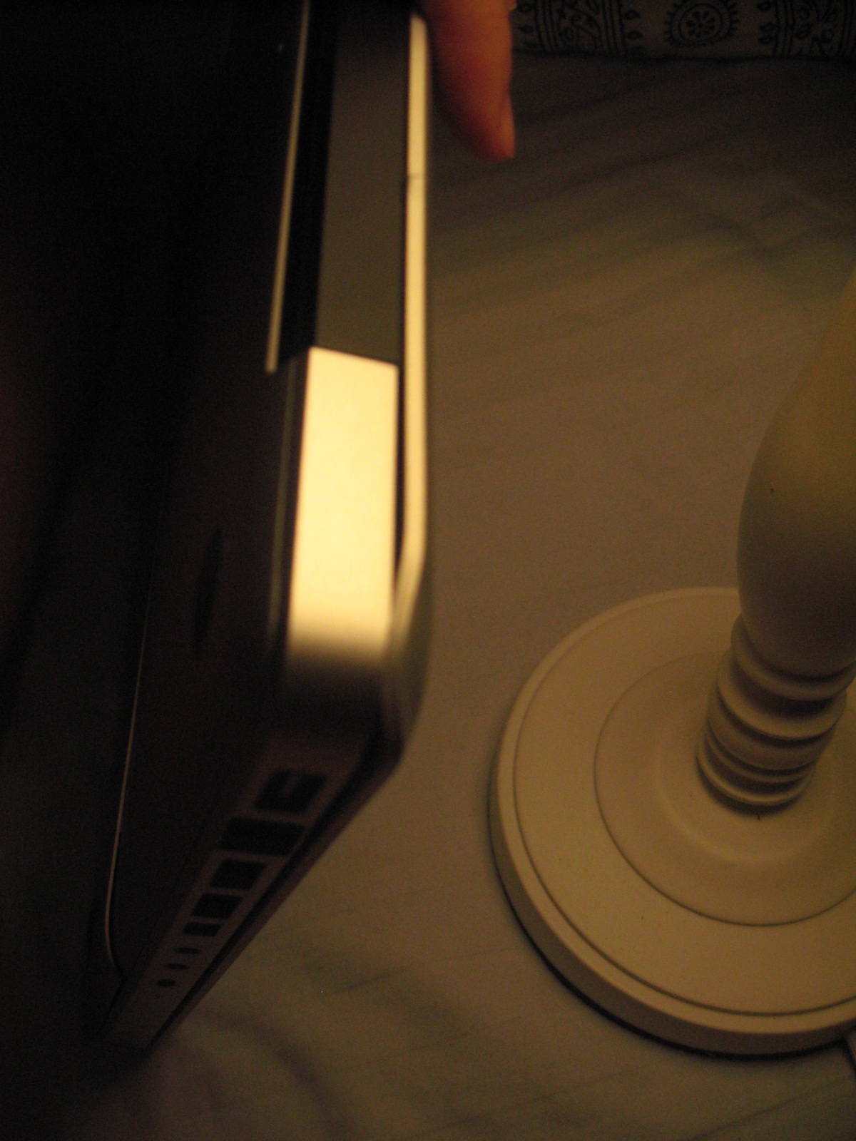

My macbook is a few months old and fell. It happened so fast, I'm not even sure what happened. I picked it up, lost my balance, and... After I stopped screaming, I realized that it still turns on and seems to work fine.. For that I am grateful. However, because of how it has dented, the upper left corner grinds upon closing and opening. It is dented in three places, evidently, 'hopped' when I dropped it. If the lid is closed, its dented on the upper left hand corner which luckily didn't break the screen but did affect how the lid opens and closes. It dented slightly on the other side as well but not enough to grate on that side when it closes. Any way to bend these dents out so that it won't 'grate' when closing and opening? It is also dented on the bottom left hand side of the bottom part evidently enough to slightly pop out the aluminum piece on the bottom...

pictures of the damage
The lower case front corner could be tapped out from the inside maybe if you pulled out the HDD, but you may need to take out the whole logic board to get the SATA/power harness out of the way.
As for the screen case, I wouldn't go at that for fear of damaging the screen/glass/backlight.
ive seen worse on here. with the front, it might be worth just restoring the internal shape with something like a dremel tool unless you want to try and tap it out, i doubt that will tap out easily
screen, well thats a little trickier as theres glass involved. you may be able to bend it back just enough to clear the upper case.
