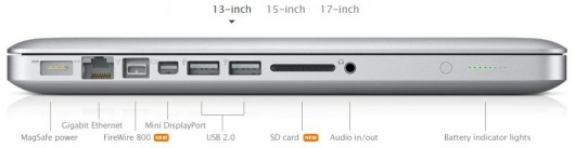

    If you have the late 2008 Aluminium MB with these ports on the side
    [​IMG]
    and a 2009 and 2010 13" MBP is having these ports on the side
    [​IMG]
    you cannot use a logic board from a 13" 2009 or 2010 MBP in a late 2008 13" MB.
    Is that understandable?
