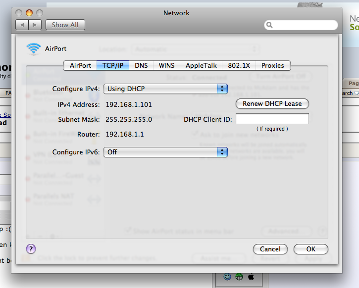

Does anyone even know what "inet" means?
I thought it might be the IP address of the Macbook, but I don't think it is.
Use the internet sharing feature in the Sharing preferences panel, it should let you bridge the ethernet into your wireless internet.
What you are seeing isn't /wrong/, and actually looks pretty good, but setup internet sharing how Leopard recommends and it should be good to go.
EDIT:
I misread the problem. The problem you are seeing has no good solution, really. By sharing the wireless with your laptop, you are effectively putting the laptop as a router between the 360 and the internet. Unless you can find a way to port-forward to your laptop, and then port-forward THAT to the 360, you will need to keep the 360 connected directly to the Linksys using ethernet or a wireless adapter you can purchase.
I had to enable Internet Sharing to get it to work at all. It works now, but the NAT settings need to be adjusted somehow.
