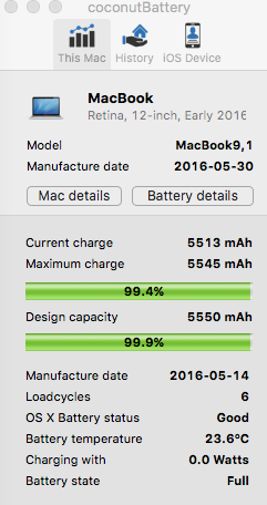

Mine has been awesome thus far, early days though, had a few deep discharges on this one too. Two weeks old.

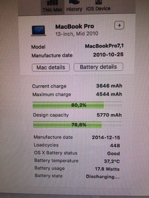

Don't wish to be out of topic as this is an MBP
But which bar is the battery health? First or second?
And is this considered healthy?
Many thanks!!!
Many thanks!!!
Second i.e. the health is at 78.8%. It should be good for 1,000 cycles at 80%, so it's not ideal.
Yeah but this battery is six years old, that 1000 cycles is nowhere near as important as age despite what many believe. Apple only give that 1000 cycles warranty to 80% within their warranty period 3 years.

Dilinger your battery is in great health for its age but watch for swelling or other issues as it is now getting to the will need replacing soon stage and battery swelling or leakage can destroy your laptop.
My friend this battery is a replaced one, dated as you can see, on December 2014...
Not even 2 years old.
I get it you were confused by the age of the laptop, but I had it replaced..
