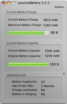

Which MacBook do you have (CD or C2D)? In the manual for mine, it says nothing about callibrating the battery, and when I searched on the net it said it isn't necessary (mine is a C2D). I have run down my battery completely once. The capacity at that stage was 91%, but since then it's back up to 100% according to Coconut Battery.
