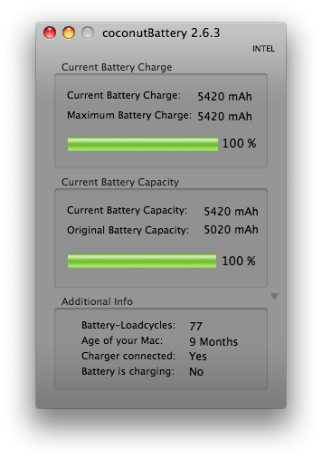

Never calibrated mine & I'm still getting 4-5 hours battery life.
