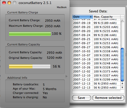

I had a problem, and was hoping you people could help me out. I have a 4 month Macbook. I recently upgraded it to Leopard. Its working great, no problems whatsoever. My battery was working great too giving me a steady 4 hours on a full charge. But suddenly since yesterday night, the battery health has gone down to 56% from a 100% in the morning. I thought it might be a calibration problem, so I let it drain completely, and then fully charged it, to recalibrate it. But still it says the same thing. Also now my battery, instead of the 4 hours that it used to last, now only lasts for a couple of hours. I am really confused about what suddenly happened to the battery. Do you guys have any suggestions about what I should be doing? Can I call apple and tell them about the problem, and try to get a new battery from them. I'm freaking out... and any help would be appreciated.

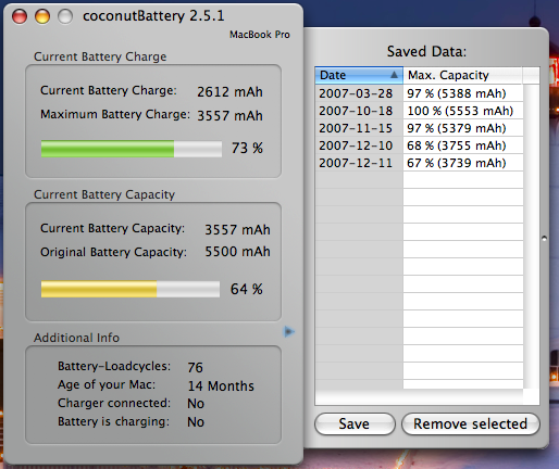

Same exact problem, went from 97% to 68%, but i didn't upgrade to Leopard. I have no idea why this has happened, so i hope i can get the battery replaced because this is rediculous. It should be above 80% for about 300 cycles, and i baby everything i own, so it's not like i trash my laptop and drive the battery crazy.

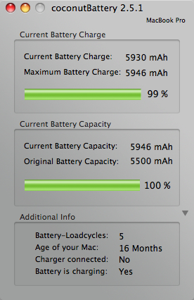

This is weird...
I especially like the no charger connected yet it is charging. 🙄 Load cycles are actually 70. Less load cycles = healthier battery life span. Lith-ion's don't like deep charge cycles.

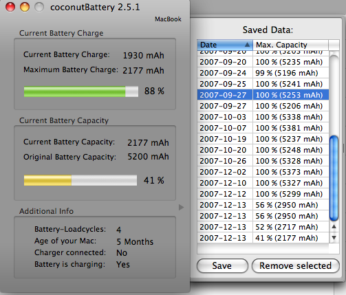

This is really wierd. The battery capacity's going down by the minute. Right now its down to 41%. With a full charge, it showed 1:32 mins remaining. This had to happen during the exams, when I need the battery in the library. 😡
