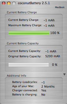

I just came back from a holiday, and booted up my MacBook, which had been shut down (or so I thought at least). When I started the computer, it booted as if from safe sleep (with blurred screen and progress bar) and then shut down immediately. When I tried to start it again, it booted normally, but it didn't recognize the battery (shows only an 'X' on battery meter). The charger led glows green and none of the lights on the battery are on, neither when the battery is connected nor when the charge-checking button is pressed.
I've tried removing the battery a few times and resetting the PMU, but neither worked. Any advice on this? Should I just contact a dealer for a new battery?
http://www.coconut-flavour.com/coconutbattery/
Download Coconut Battery, open it, and tell us what it says about your battery.
gauchogolfer said:
It's time to return that crappy battery, my friend.
That VERY crappy battery! 😱
But then again my PowerBook battery capacity is at 9% so it's not that much better. 😱
I suspect there's something badly wrong with the power circuitry (either in the battery itself or the PMU) rather than the battery cells themselves, given the negative readings for everything including number of loadcycles.
Good point. OP, have you tried a PMU reset as well?

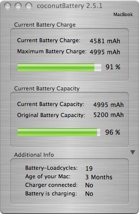

Same Situation
I had the same thing happen this morning. I've been scouring blogs finding similar issues and thought I would add my two cents. I've had my Macbook for about a month. I used the coconut program and this is the results.
I've tried removing the battery but no dice.

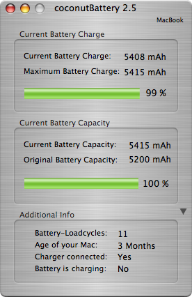

This is kind of unrelated to the topic, but I just downloaded coconut battery for the first time.
I've had my macbook (white 2.0) since early july and this is what it tells me about my battery:
so can my actual currect capacity be higher than original? if so i'll keep treating it how i'm treating it, 😉
i have exactly same problem in my MBP
i already order the replacement battery as my MBP battery is the one afected in the recall.
Actually i was thinking to keep the old battery for back up instead of returning it to apple 😛 hehehe but i guess my evilness wont take place because few days ago the old battery just suddenly stop functioning, and the battery indicator say no battery attached and same result with -1 in coconut battery.
when i get he replacement battery it works okay, so i guess the problem is in the battery it self rather than on the MBP or MB.
so goodbye my "FREE" back up battery , i guess i'll just send it back to apple to dispossed it safely.
