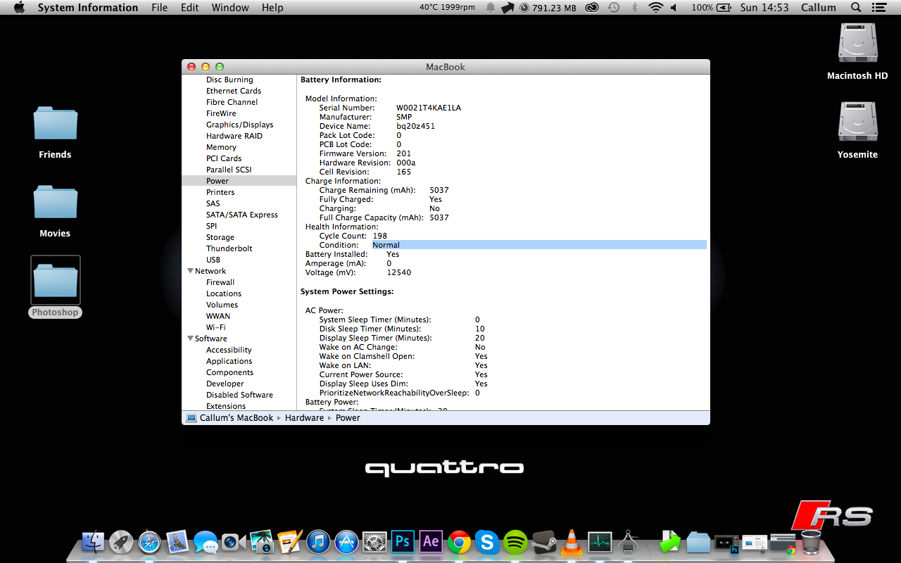

Yes, using it today feels different, I have to put quite a bit of force on the trackpad for it to click... I think i definitely need to take it out.
Surely the battery would state that its condition is not normal.
All that tells you is that the battery function is OK at this time. Your system has no way to monitor the physical size and shape of your battery. All it can do is report electrical response.
You may even find that even in that extreme swelling battery that the battery may still be functional, and may hold a charge (and also may show "normal" in the system - assuming that the battery can stay connected with that big bulge.) I wouldn't test that theory, however.
