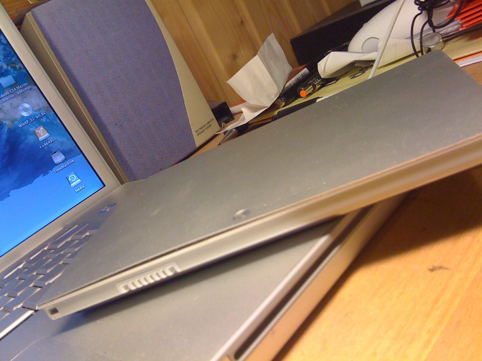

well I don't actually know if anything happened to the MB charger, but I realized my battery is dead, after painfully calibrating the battery it started to swell up(see pic)
i read about the extended battery replacement program and went to my local mac store to get the replacement but they said they had to take my machine in for a checkup first.
So i called apple and they checked my serial no against the database of eligible machines and told me that my machine was just two weeks to old to get the free replacement.
Now I can not 100% tell if the swelling of the battery was due to me charging my MBP with an MB charger because the machine is 30 months old, but it seems quite unlikely for the battery to exhibit such symptoms since it was hardly used before.

The swelling had nothing to do with the charging on a wrong charger. It is a defect in material or workmanship. I had a early 2008 macbook pro battery replaced with the same issue. I would take it to the apple store clearly that is a problem with the battery not caused by normal cycling
but I called apple and gave them my serial and they said that my specific machine was not among those that had been acknowledged for extended repair.
Should I still try leaving it for some days at my local mac store?
