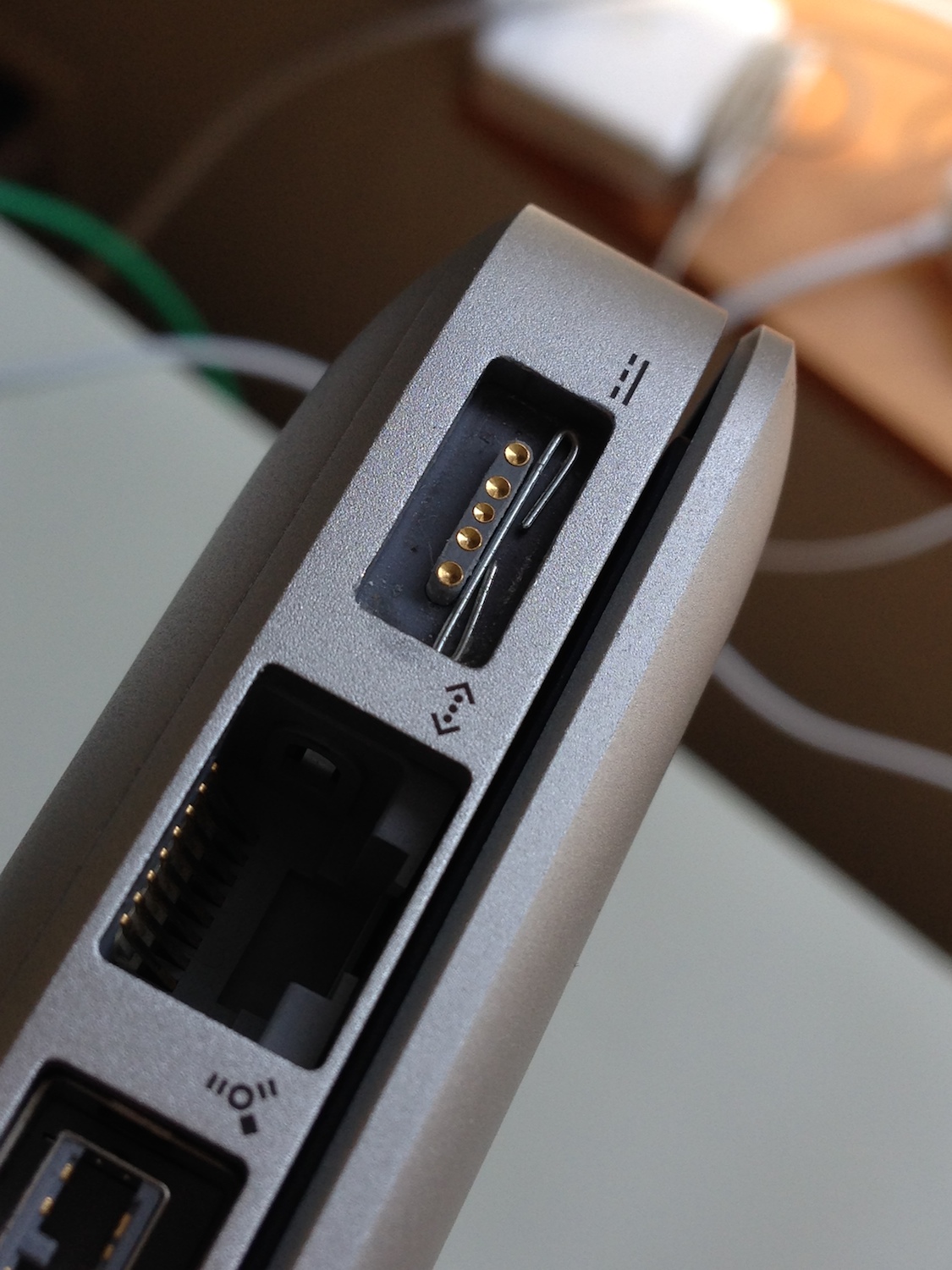

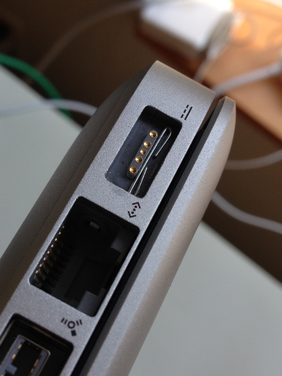

Here's a picture of one for reference. If the staples are open (rather than closed) it's much worse.
What exactly did you use to clean it with? (other than the cloth)
I've had pretty good success on multiple client machines with rubbing alcohol and a stiff-ish brush. Just be sure to disconnect your battery and make sure the alcohol dries out before reconnecting.
Otherwise it sounds like the port itself is going. In that case it shouldn't be too much to replace (as others have stated).
