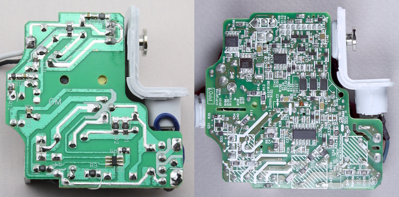

Manufacturers of counterfeit Apple products often go to great lengths to make their knock-offs look genuine, which brings the added risk of concealing potentially dangerous flaws in substituted electrical components.
In the past we've covered the efforts manufacturers go to when counterfeiting iPhone and iPad chargers, courtesy of product teardowns on Ken Shirrif's technology blog. Now, a new post on Shirrif's site offers a detailed teardown and analysis of the differences between a counterfeit MacBook charger and a genuine unit, providing a great example of how cosmetic similarities can hide major safety defects.
A counterfeit MagSafe 45W charger (left) and a genuine 60W charger (right).
Shirrif notes that counterfeit chargers he's examined in the past have usually had external flaws that give them away, but that this latest MacBook charger knock-off almost had him fooled, too.
The exterior text on this charger was correct, no "Designed by Abble" or "Designed by California". It had a metal ground pin, which fakes often exclude. It had the embossed Apple logo on the case. The charger isn't suspiciously lightweight. Since I've written about these errors in fake chargers before, I half wonder if the builders learned from my previous articles.
Only when Shirrif cracks open the charger are the differences laid bare. A real Apple charger is packed full of complex circuitry, but the counterfeit contains a fairly low density board that uses a simpler power supply with a dangerously small isolation gap between the AC input and the low-voltage output.
Shirrif also identifies a distinct lack of insulation tape between the two voltages on the circuit board, a metal grounding pin not connected to anything, and a fluctuating power output. See his post for the full comparison.
Three years ago, a Chinese woman was electrocuted by a counterfeit charger while charging her iPhone, highlighting the significant dangers these products pose to consumers. Users who suspect they have a counterfeit charger can take part in Apple's third-party charger takeback program to safely dispose of the adapters.

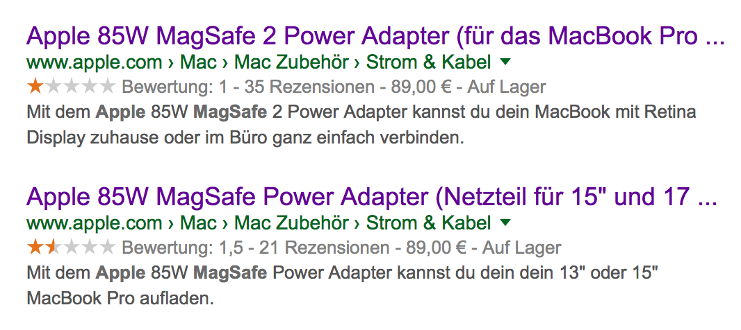

I use the charger on a daily basis at university. Already my third now in 2 years as the cable breaks all the time. I bought the best fake charger I could find on amazon for a third of the price. 89€ are just too much Apple. I even went to Apple Store in person to complain but they did not give a ****. They said you could do Apple Care and then it is maybe replaced in case... ratings of the original MagSafe 1 and 2 in the online apple store are also very very bad (1 star):

Apple's version looks vastly superior compared to the knockoff but the problem is, they are just as faulty. I've personally replaced 4 power adapters in the last 3 years. Consider me unlucky, but I never had to replace any power cords on any other laptops I've owned. I didn't mind it so much until the Applecare ran out, then you have to pay retail for replacements. I love the design of the magsafe (having small children), but it definitely needs improvement on reliability.
Using a fake charger is certainly a terrible idea, but so is charging $80 for a replacement MagSafe charger.
