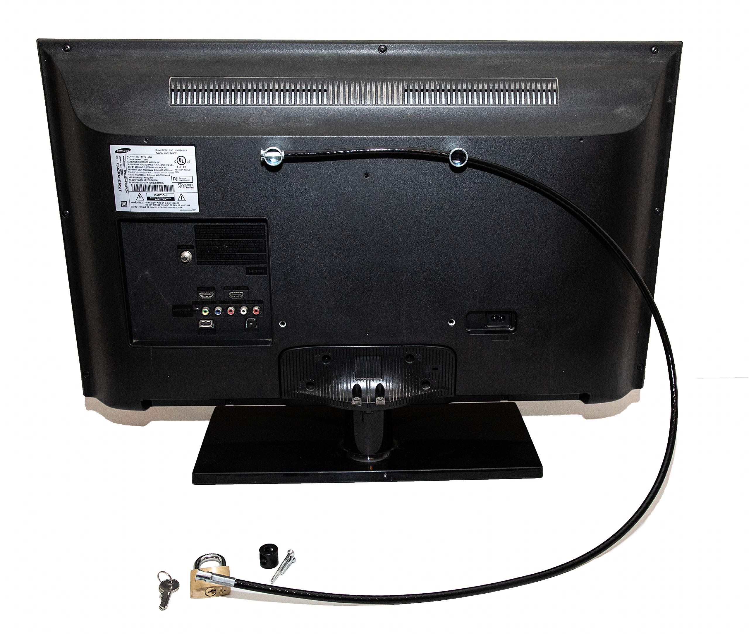

My desire is to take a 32" TV and the black '08 MacBook to an event and place unattended on a table with a looping iPhoto slide show. Doubtless they would get damaged or stolen but together are only worth perhaps $100.
Protect the MacBook with a Kensington lock or an equivalent.
Do the same with the TV or chain it to the table.
Both are fairly cheap and effective solutions. :)

The '08 book does not work with the Sharp either, but my newer books do. For whatever reason (OS version?) at least I now have a combo that I can use and shall consider a cable lock.
