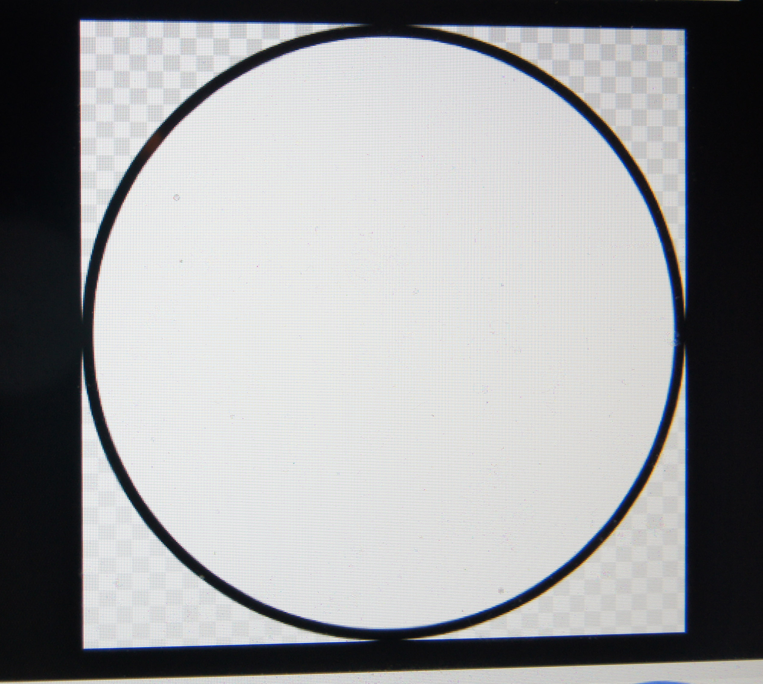

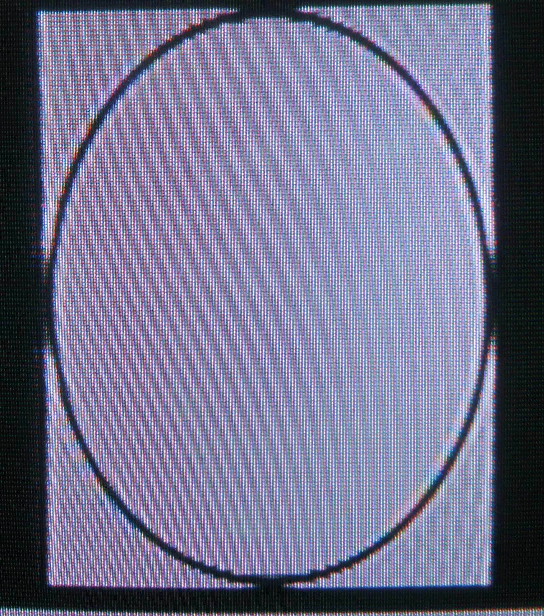

I have tried all the different sizes available. I get the pillar boxes on both TV and Mac but the TV display remains off:
The second is what I get on the TV and both displays are showing pillar boxes.
Ok, I've done that, but I still can't get a letterbox on the TV for the display to be in correct proportion.
