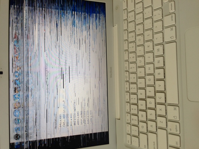

Hi,

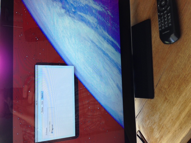

I am hoping someone may be able to help me - i have an old Macbook A1181 which has now got a display error, upon starting the macbook the display is fine for the first minute or so - then it starts developing a scrambled type of image where the screen is so unstable the image is distorted and scrambled - almost like interference..... I have connected it to my hdmi tv using mini dvi adapter and the image is stable on the tv albeit not great quality....
My question is it the screen that needs replacing or is it the logic board ???
I have attached a couple of images so you can see what i mean and any advice greatly appreciated....

HELP - I have just read an article regarding "reflowing" the gpu !!! Basically cooking the gpu to re set (flow) the solder correctly. There are lots of people that have had success doing this !!! Is it worth me giving it a go - what's the worst that could happen ?!?! I get a broken MacBook ....
So the GPU isn't needed for the output to the OP's TV?
Yes it is, but it's not 100% broken, that's why it works for a while or that's why it works with bad quality. It's a known problem with the old MacBooks and MacBook Pro's. I had exact the same problem with my old (non) retina MacBook Pro. Apple had a special program for it to replace the logic boards.
I had display issues similar to this on a Thinkpad. It was the display cable, not the graphics card. I replaced it and it works perfectly fine now.
How would a broken display cable cause the issues on the screen connected through the external display connector? Those are separate connectors on the logic board.

Thanks again - are you able to tell me exactly how you cooked it in the oven - its worth a go.....
I didn't read that the external display image was scrambled. I read:
Well I have cooked my logic board tonight !!! I will put it all back together in the morning and we will see if it works......... #omg
Dream !
Guys thanks for all the advice just thought I would let you know that cooking my logic board to reflow the solder has worked a dream.... The MacBook is alive and screen is perfect. I'm a happy chap.
