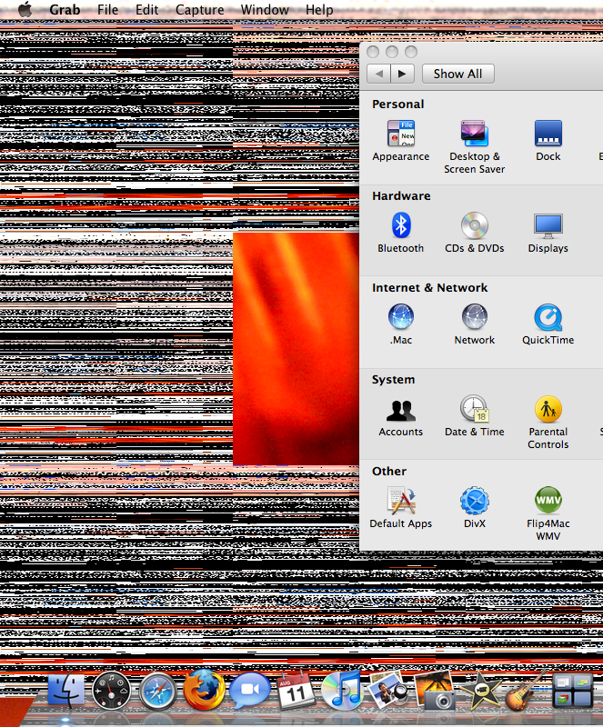

For the second time in a few days now (I think it may have happened once before, I forget) my MacBook, pretty new (bought it new early June), seemingly randomly (I was just opening a WMV in Quicktime), the display completely screwed up. I used Grab to take a screenshot of a sample of my screen and attached it - for some reason, part of the window (which was covered by Finder when the problem happened) stayed normal. I'm not sure what's going on but I'm guessing it's OS-related (or otherwise software) and not a problem with the display itself, since Grab notices it, too. Why does this happen, how do I prevent it, and what can I do - save restarting - if it happens again? Thanks!

Does this problem happen with VLC? If you haven't got it download it from here. See if you have the same effect with WMV files.
http://www.videolan.org/vlc/
Failing that, remove the FLip 4 Mac software and reinstall or you can repair the disk permissions using disk utility.
Worst case run a SMC reset and a PRAM reset
SMC Reset (Macbook MacbookPRO)
MacBook, MacBook Pro

I happened to be opening a WMV file in QT the last time it happened (tonight), I forget if I was using QT the time it happened before. I do have VLC and if this happens again I'll see if QuickTime is the cause of the problem - thanks.
