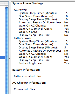

Very odd. My Macbook has also developed a similar problem in that it shows an "x" on the battery icon and also does not detect the battery although it will continue to function normally with the AC power cord unplugged. It doesn't detect the battery but the battery is obviously powering the system. I have reset PRAM and the PMU without success. One other thing that is odd is that the screen will dim when I unplug the magsafe, which it should as I have that option selected, so it is detecting the switch from AC to DC but still does not detect the battery.

Called Apple, told me to go visit the nearest reseller.
They analyzed if it was the battery itself or the whole power source. Was just the battery in my case.
They are sendimg me a new one and have kept the old one.
Sucks...
My Macbook battery has, apparently, spontaneously healed itself after I ran it down to the point where it went to sleep. When I plugged it in it shows normal battery indications - for not at least.
