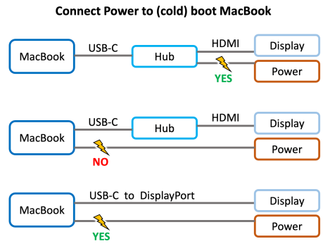

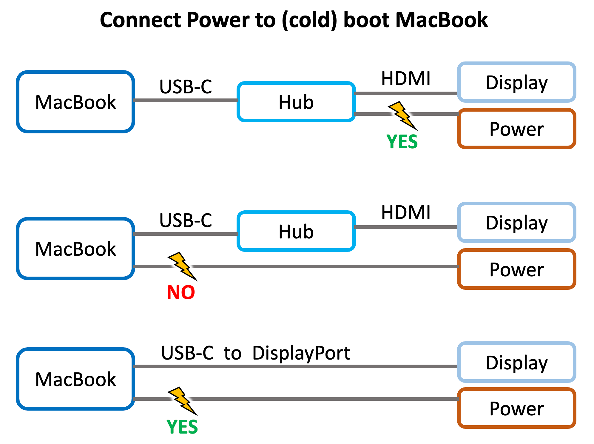

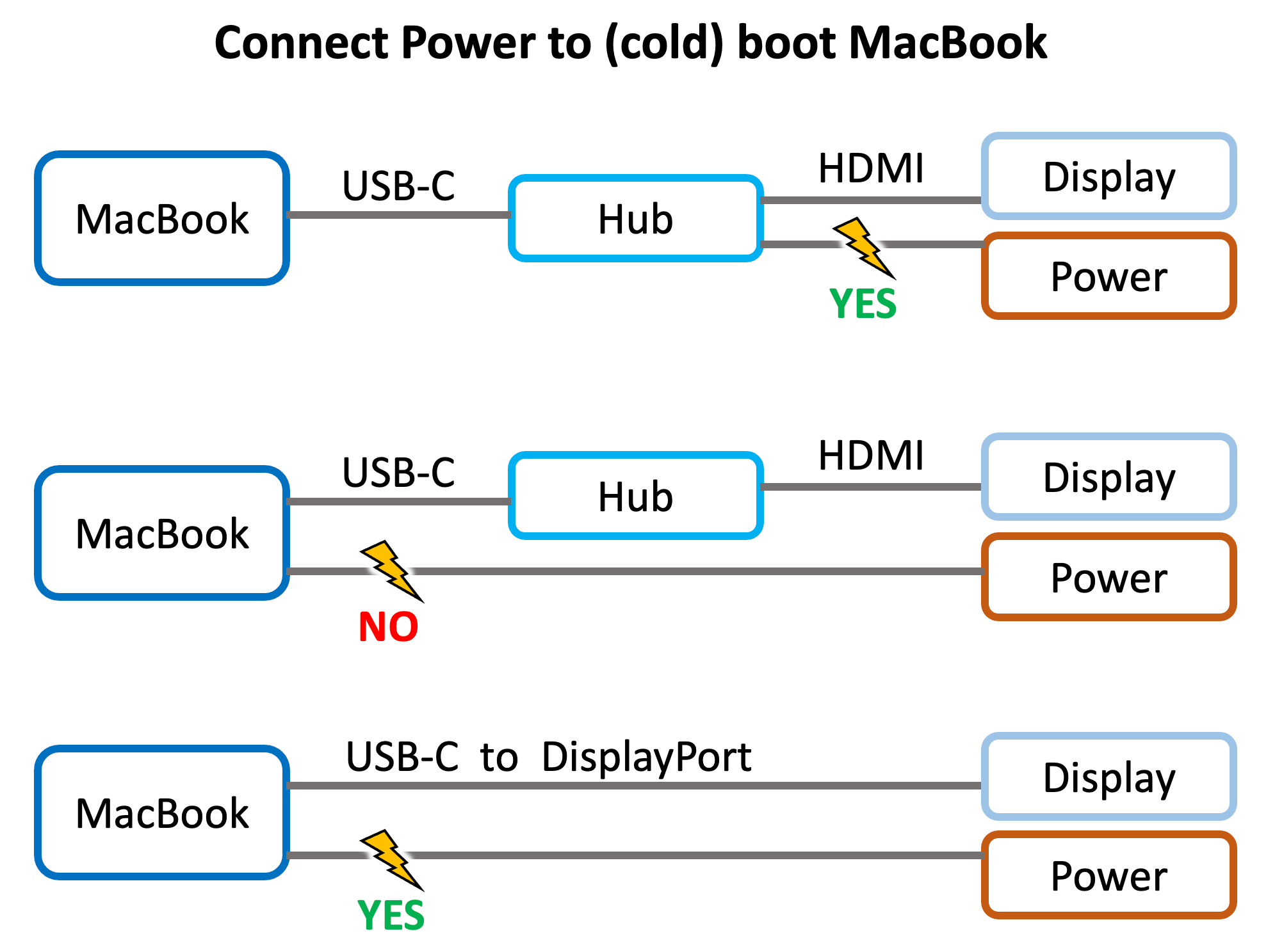

The MacBook must be connected to an external display (directly or via hub). Then, when the power cable is connected, it boots.
If the display is connected via a hub, the MacBook must receive the power (trigger) via USB-C PD.
Contradictory to most other information, for some users it seems to be possible on Apple Silicon Macs as well:
Did you have an Intel MacBook before and perhaps confuse the two? There it definitely works. They must be set to auto-boot (auto booting when opening the lid). Which Apple Silicon MacBooks always are.
The MacBook must be connected to an external display (directly or via hub). When I connect the power cable, it boots.
I have one MacBook/hub that only does a cold boot in clamshell mode if the power supply is connected to the hub and the MacBook receives the power (trigger) via USB-C PD.

For Intel MacBooks, they can only boot with the lid closed if an external monitor is connected when plugging in the power cable.

I have not found any official documentation that cold boot in clamshell mode works at all on Apple Silicon Macs.
On the contrary:
(…) It got escalated to Engineering and they came back and said that the Intel chipset enabled that functionality and the Apple Silicon chipsets do not.
(Nevertheless, attached an image of how I have to wire my 2019 and 2020 Intel MacBooks.)
