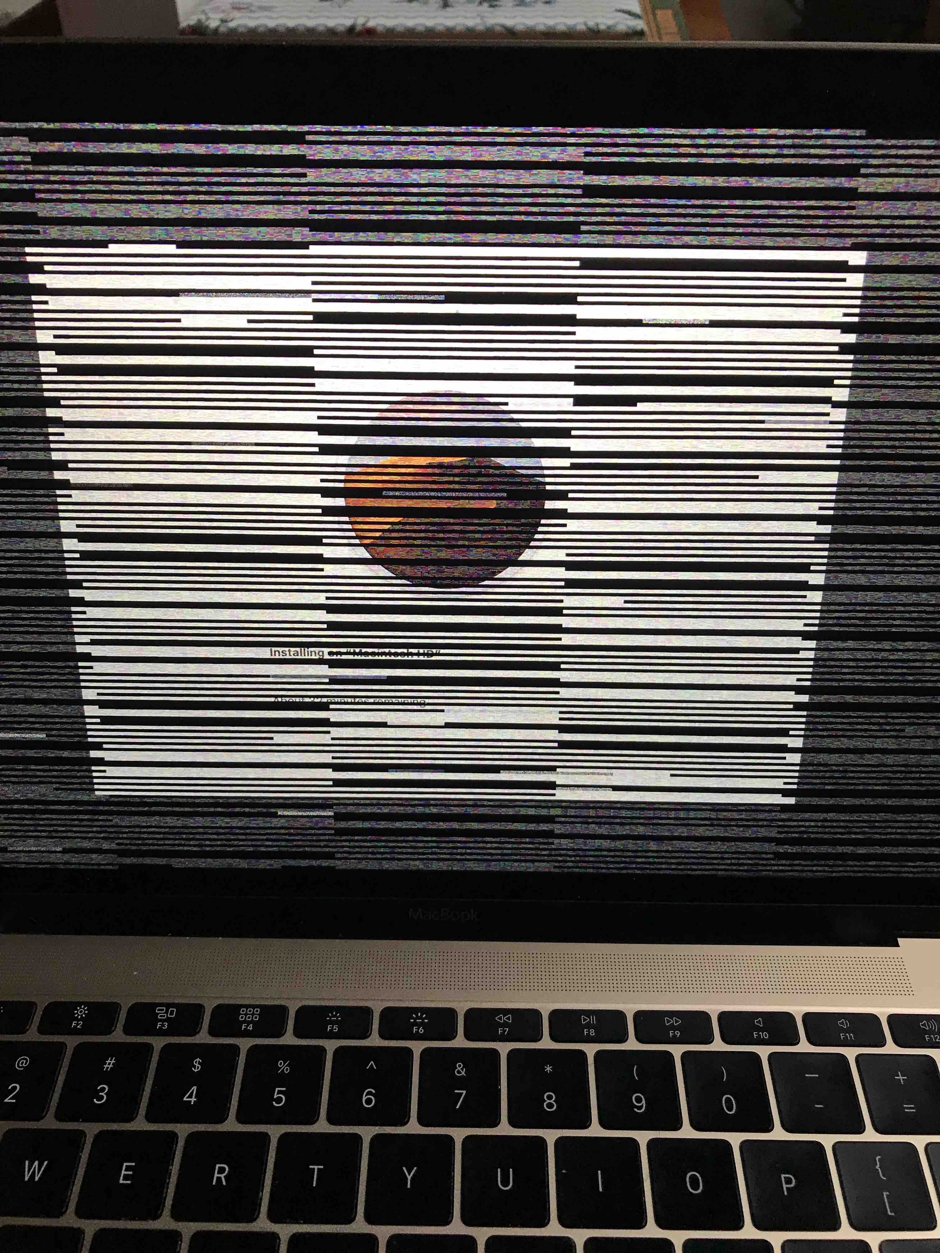

I have a MacBook 12" Early 2015 that has a hardware issue. Could be the logic board... See the attached jpg. Is it worth fixing? Any clue as to the cost? Is this something I can fix? I do have a soldering iron...

You probably can’t fix anything on modern logic boards like the one in the MacBook - the structures are simply too small to solder with a standard iron. Look it up on the teardown by iFixit.
To me that looks like a problem with either the integrated GPU and/or Ram. Out of warranty, your best bet probably is to find a rMB with defective battery or keyboard and transplant the little logic board (not sure if it really is a simple transplant or whether you might need special tools to “authorize” the new part in some way).
If you intend to rather throw it away and get a new device, you could make a last attempt by “baking” the PCB, i.e. putting in in an oven for a defined time at a defined temperature, hoping that potential hair cracks in the solder may be closed again. Look it up on Google, it has been done in the past for problems with dGPU’s and other PCB’s, however there is NO success guaranteed! Consider it a last attempt after everything else failed, before putting it to garbage.
Have you tried an external monitor? See what the video looks like there. If it’s fine, you’re likely just looking at an issue with your screen or the cabling. Check it out and let us know!

I have tried to connect via Finder's View option. The MB seems to be dead when in this state as it never responds to any incoming connection requests. It did before so it's not a firewall issue.
What I meant was have you tried hooking an external monitor up to the MacBook?

I dont have the hardware to connect a monitor. Best I can do is try to reach it via the network.

I finally got to the Apple Store in nearby Corte Madera, CA. They suggested I send it in for repairs. However, I have a lot of personal data stored on the ssd. Given the very short time of operation (2 - 3 minutes), is there a Terminal Command to erase/format the SSD?
Thanks for your comment. Is that something that only Apple can fix or can a good local shop fix it?
I was kind of making a joke. Your screen looks very similar to LCD TV's when the T-Con board goes bad. I wouldn't advise you tackle this yourself with regard to soldering. It requires a scope for magnification and micro-soldering tools. Apple will likely tell you it's $800 to fix and try to convince you to get a new one instead. If you really want to get it fixed then search on YouTube for Louis Rossmann (The Rossmann Group) and/or Jessa Jones (iPad Rehab). They both have very skilled technicians who can literally fix just about anything Apple makes. I think the cost is ~$300 and I believe they don't charge you if they can't repair it.
