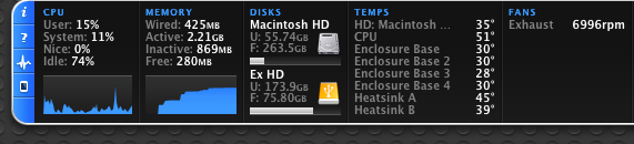

It seems rather odd to me as well, but it's true. The fan is spinning at 6900-7040 rpm. I currently have it on the mStand and to test whether it's simply the noise or the speed, I lifted it up and tilted it to the left and right until the fan started spinning. Now it continues to do so until I lift it up again, tilt it in one or another and put it down again.
I should note that I've also replaced the cooling paste with Arctic Silver 5 this weekend in case it might be of influence.
Istat:
