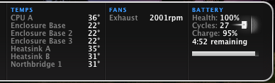

here we are....
as i post this the fan is running like crazy
It doesn't seem right to me that your heatsink A is much hotter than your CPU. Assuming your readings are in degree C, 127 C is unusually high for the Al-MB. (see mine for comparison)
What are the temperatures when you boot up in the morning? If it is anywhere this high, you need to talk to Apple.

Whatever that Lexmark process is, it's using up the most power. Try quitting that process and see if it brings everything down to normal...
OP doesn't have Alu MB ... read first post.

it was def that lexmark thing...what the ****... i guess i need to uninstall that driver...thanks alot guys!
fan stopped as soon as i quit the process
iStat gives strange readings on 2GHz Core Duo machines - one minute it says 120F for Heatsink A then will suddenly say 25F....
Sounds like a print job that never finished.....
