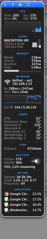

The fan on my macbook 1,1 is constantly running really loud. It started this morning when i was using it i have tried restarting the computer shutting it down but nothing has worked. Smc fan control says it is 61degrees celsius and the fan is running at 5117rpm and higher. also here is a picture of istat.

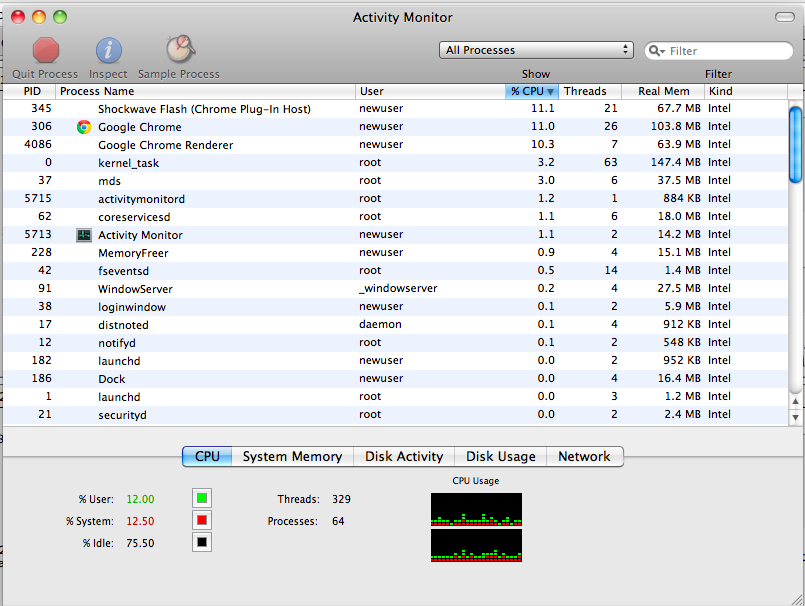

Here is a screenshot of activity monitor.
When you took this screenshot are your fans running on higher rpm?
yes, the fans start as soon as the computer fully boots up. They will start full blast even if nothing is running. Could it be that it is a part that needs to be replaced?
Well it may be a fault with the sensors on the heatsink - the problem is that iStat does not work properly with the Core Duo MacBooks.
As you can see from your original screenshot the readings for Heatsink A at 126 C (!!) and Heatsink B is 7 C - both of which are clearly rubbish.
As far as I can remember they are false readings but I suppose in your case they may be correct - tough I would seriously doubt it..
Perhaps the first job would be to remove the heatsink and fan - clean out the fan and check that the 2 sensor connectors are properly in place.
