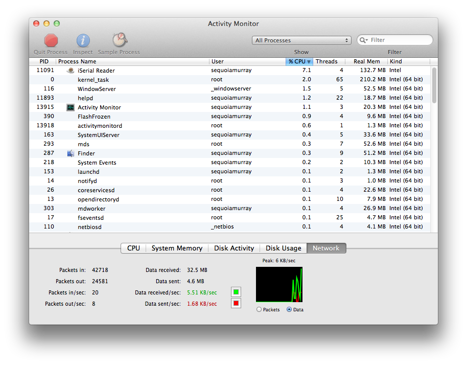

This is my second post about my MacBook's fans going crazy. Today I was surfing the net on tumblr, and this guys blog has music on it. As soon as I heard it, I turned it off. Next thing I know my fans start going all crazy. I'm not sure what the problem is.. I restarted my macbook and as soon as I turned it back on the fans started going crazy again. It's doing the same thing right now as I'm writing this post. Just randomly started going to 6200rpm. I'm not doing anything but writing this post. Is this another bug in Lion? Or is there something wrong with my macbook. This hasn't happened for some months and it's really awkward that it decided to go off today.. when I wasn't really doing anything that required my fans to go off. Thanks for your help in advance =)

I attatched a screenshot of Activity Monitor if this will help solve the problem.. Though it doesn't look like anything is really using up the CPU.

Strange. Must be an error in reading the temps of the mb. Well try repairing disk permissions (always seems to fix any issues I have) and like I said try smc fan control to adjust them manually.

I uninstalled iWeb
System:
Macbook 2,1 with iLife 09 upgraded to Lion
Symptoms:
Fan often on
Activity Monitor often shows mdworker consuming high CPU % with 10+ GB disk activity after every restart
Console shows many error messages similar to
mdworker32: (Error) ImportPluginLoading: Couldn't load plugin '/Library/Spotlight/iWeb.mdimporter/'
Failed workaround:
had a different group (admin) than other .mdimporters and more permissive permissions, tried fixing with chown and chmod to no avail
Eventual workaround:
Uninstalled iWeb and removed directory
