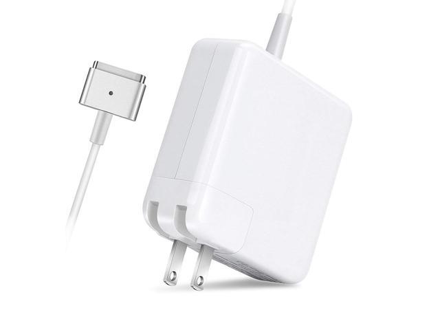

In the old days, the power bricks looked like this. As you can see, it's a two-pronged plug:

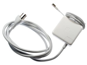

Apple also provided a cable. You took out the two-pronged plug and replaced it with the grounded cable:

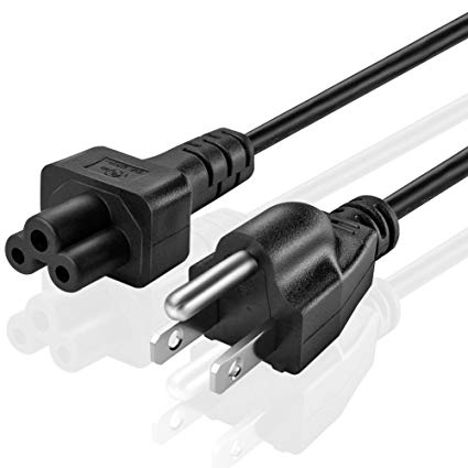

Usually if a laptop charger is grounded it accepts a 3-prong "Mickey Mouse" cable like this:
