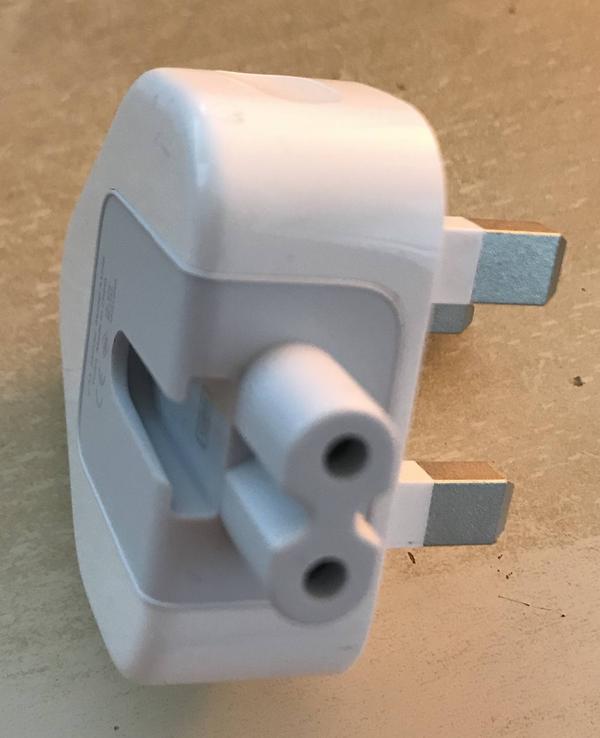

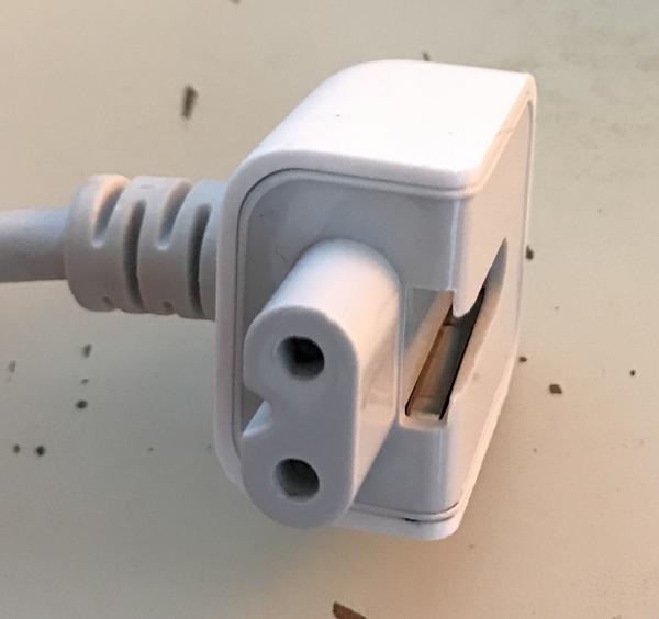

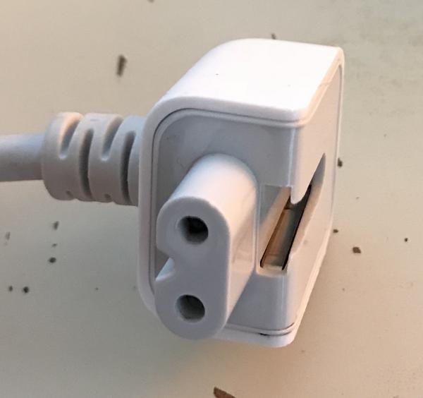

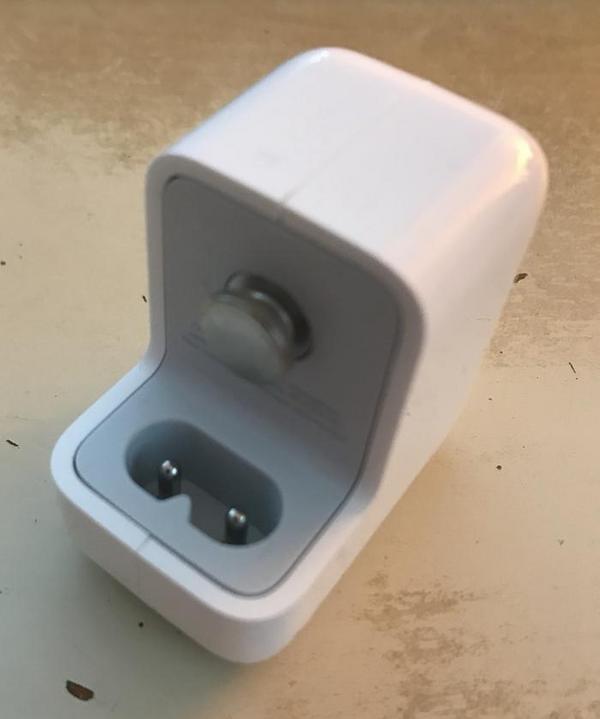

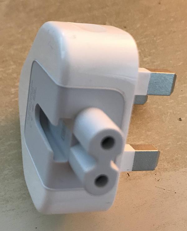

The earth pin isn't actually connected to anything 🙂
1. Power adapter with round metal piece - this is the earth connector
2. Regular three-pin adapter - note only plastic on the edges where it touches the round piece
3. Extension cable with three-pin plug (actually from my old BlackBook) - note metal on the edges, connecting to the earth on the adapter
Should do yes, it did for me, although mine is an old one. Shame they stopped bundling them (like everything else I suppose).
