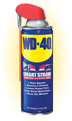

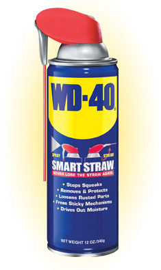

Get over it

Get over it
Ok, when I next spend £1,200 on something I'll be sure to make sure there are things wrong with it to aid me in my ability to 'get over' things.
C'mon, it's not much to ask is it?
Sorry sorry sorry, I'm in a bad mood, and didn't mean to bait/flame/troll.
I still want a smooth lid back though. 🙁
