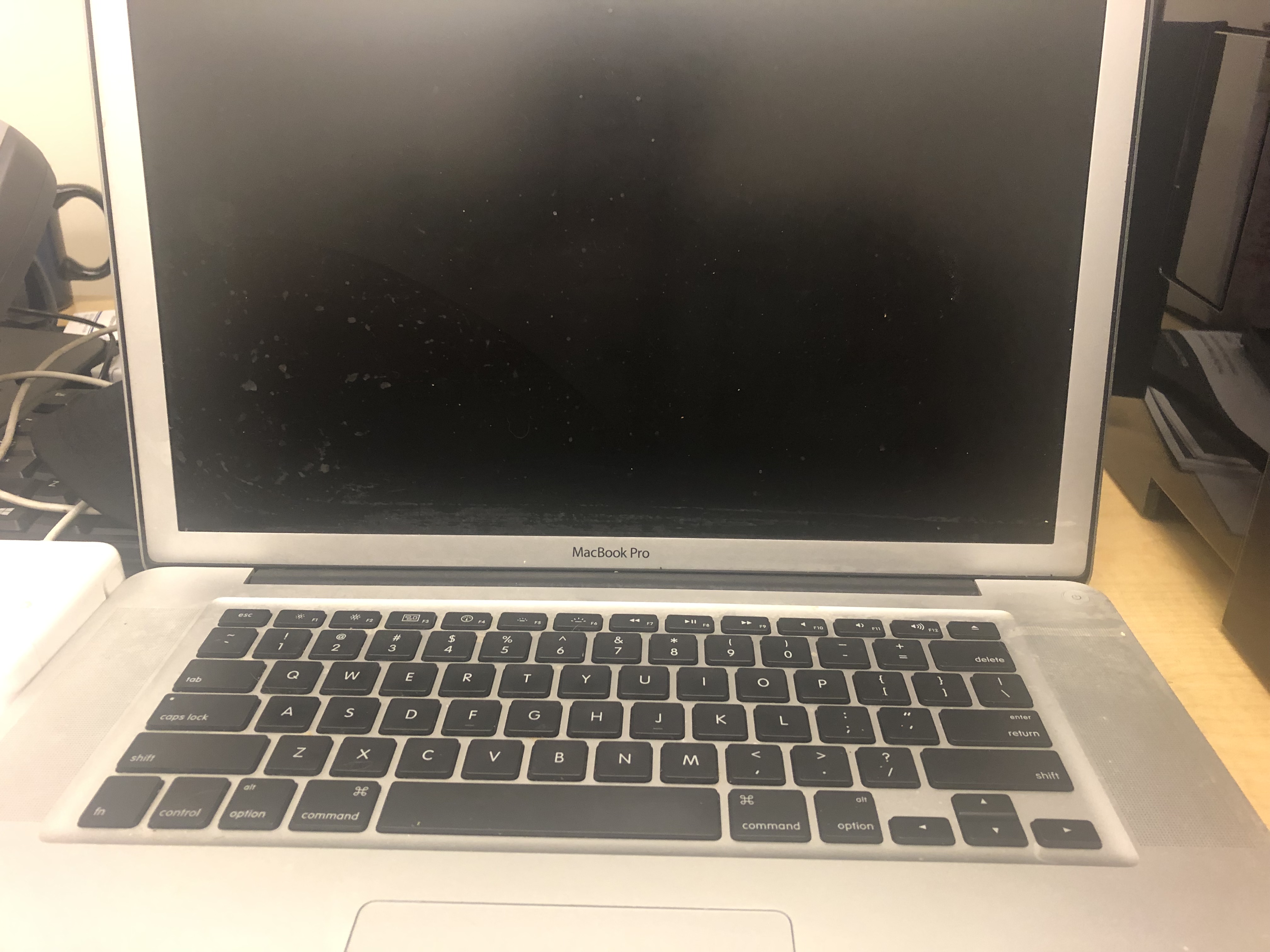

Hi. I have a late 2009 MacBook pro. I don't use it for much more than internet and word documents. I think I got malware online yesterday. My screen is gray with a blinking icon of a folder with a question mark on it. I've rebooted it several times and done two Pram restarts and still nothing.
What can I do?
