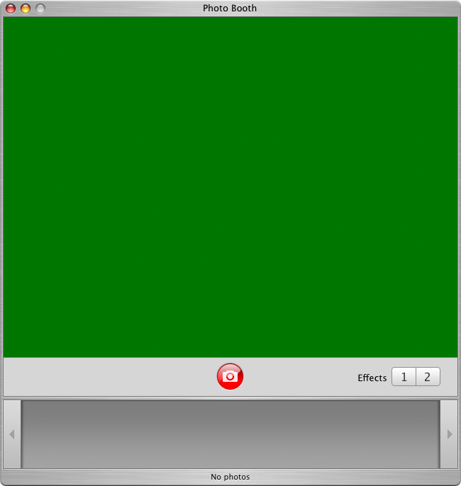

Using a friends MacBook, but the iSight camera doesn't show anything when using Photobooth... Any ideas why this might be?
Yup, green light to the right of the camera is on.
This is all that is showing when you launch Photobooth (see attachment)

The camera is dead you8 should take it in to the Apple Store and have it exchanged.
This same problem happened to me. The iSight 'on light' turned on as soon as I started up my MacBook and had that weird green picture when I opened Photo Booth. Nothing could fix it... until I rebooted. Now it works fine and it's never happened again.
Have you tried rebooting? (Obvious, I know, but sometimes the best of us overlook such simple things 🙂 )

Check whether it works in other apps before writing it off as dead. Also, unplug any USB and Firewire peripherals that may be taking up a lot of power. 🙂

10.4.7 / firmware update fixed it.
Weird - either the 10.4.7 or the 17" fan firmware update fixed my camera. Perhaps it does the PRAM reset mentioned above.
Solution for this on MacBook DC2
I just fixed this on my new Dual Core 2 MacBook. I decided to brave the annoying registration on this site to comment here... My camera light was on but the video window was either all black (in iChat) or all green (in Photobooth).
I was able to fix this by powercycling my MacBook...
  1. Shut down the machine
  2. Pull the power cord
  3. Remove the battery
  4. Hold down the Power Button for 5+ seconds
More info from Apple: http://docs.info.apple.com/article.html?artnum=93240
