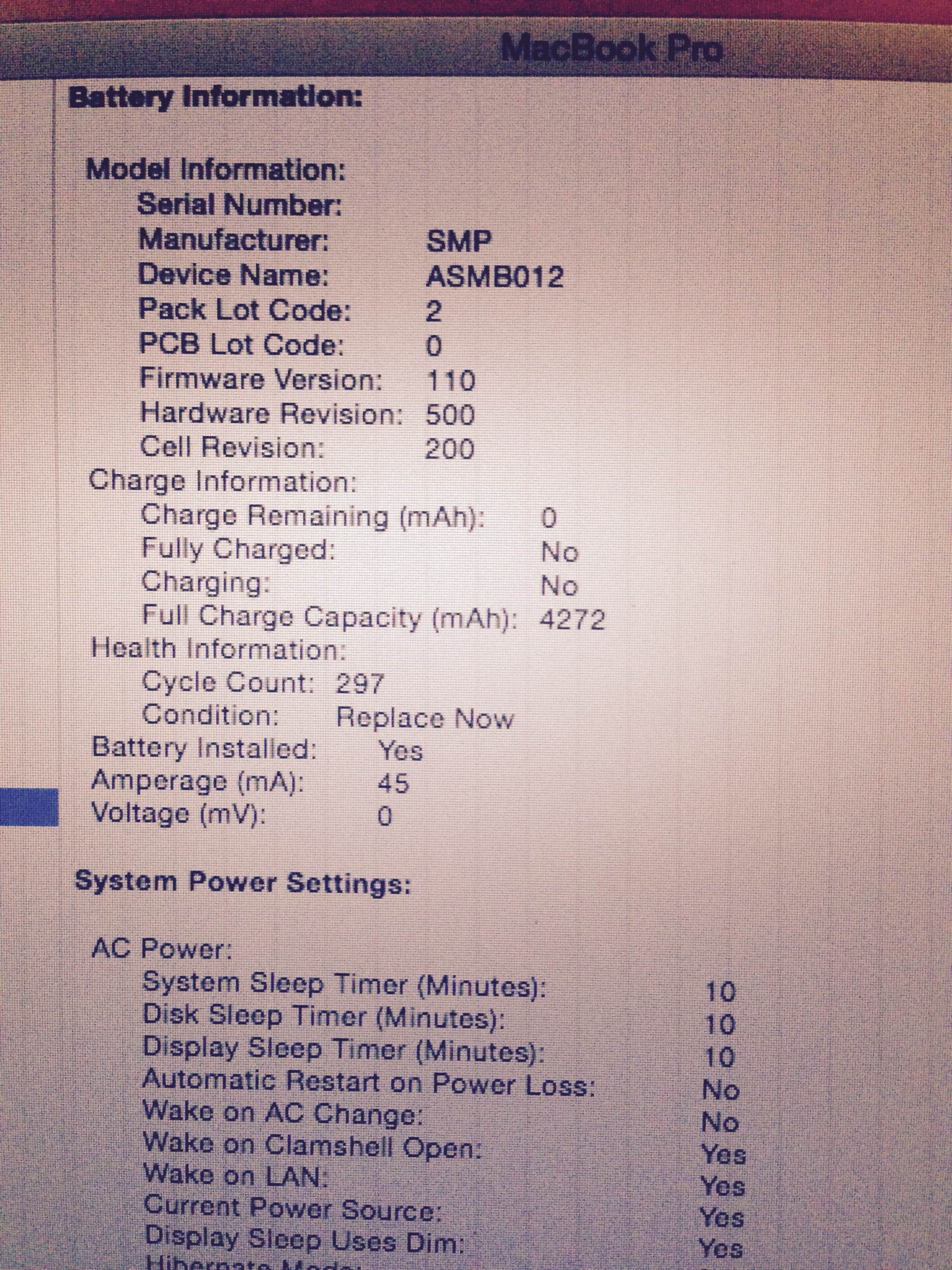

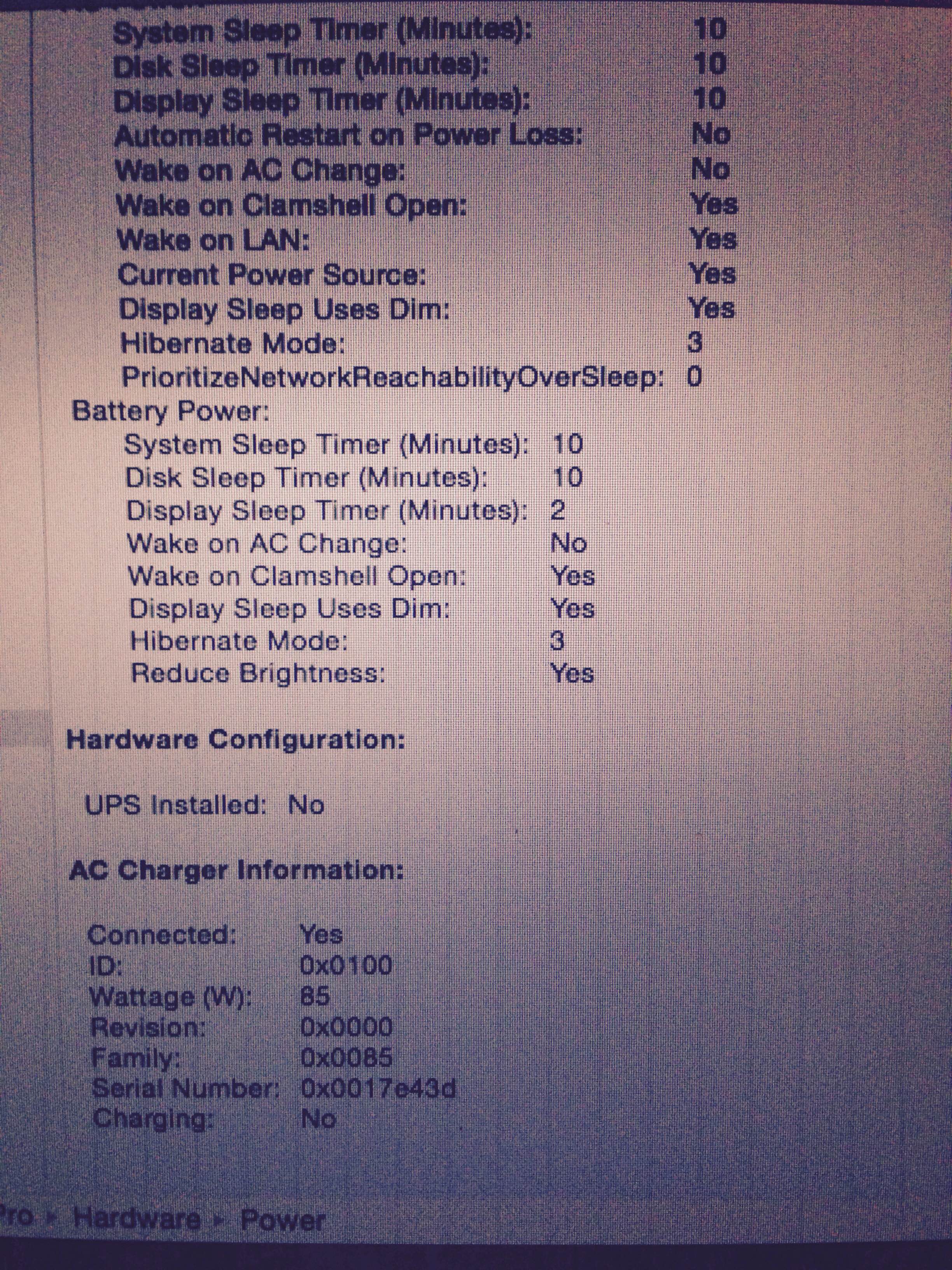

[doublepost=1461202674][/doublepost]Or could it be part be the power ?
[doublepost=1461203686][/doublepost]
You said "... as I was typing this I moved the lap top a little and it happened ."
But, you did not say what "it" was? What happened when you moved the laptop a little?
If you mean the power shut off, it's very possible that the power connection is simply not very good. Check that both the adapter connector, and the internal magsafe port are both clean and undamaged. I have often seen that one or more of the little gold contacts (the row of five pins and the "cups" that all fit into) will be loose. You can try to gently move those.
And, something there may be loose enough that you lose the connection when the adapter wire moves "just a little."
Your battery is certainly bad, so you can try removing the battery completely, and see if that helps you stay powered up more reliably. (I haven't had a battery in my 2008 MacBook for a couple of years, and use it plugged in daily.)

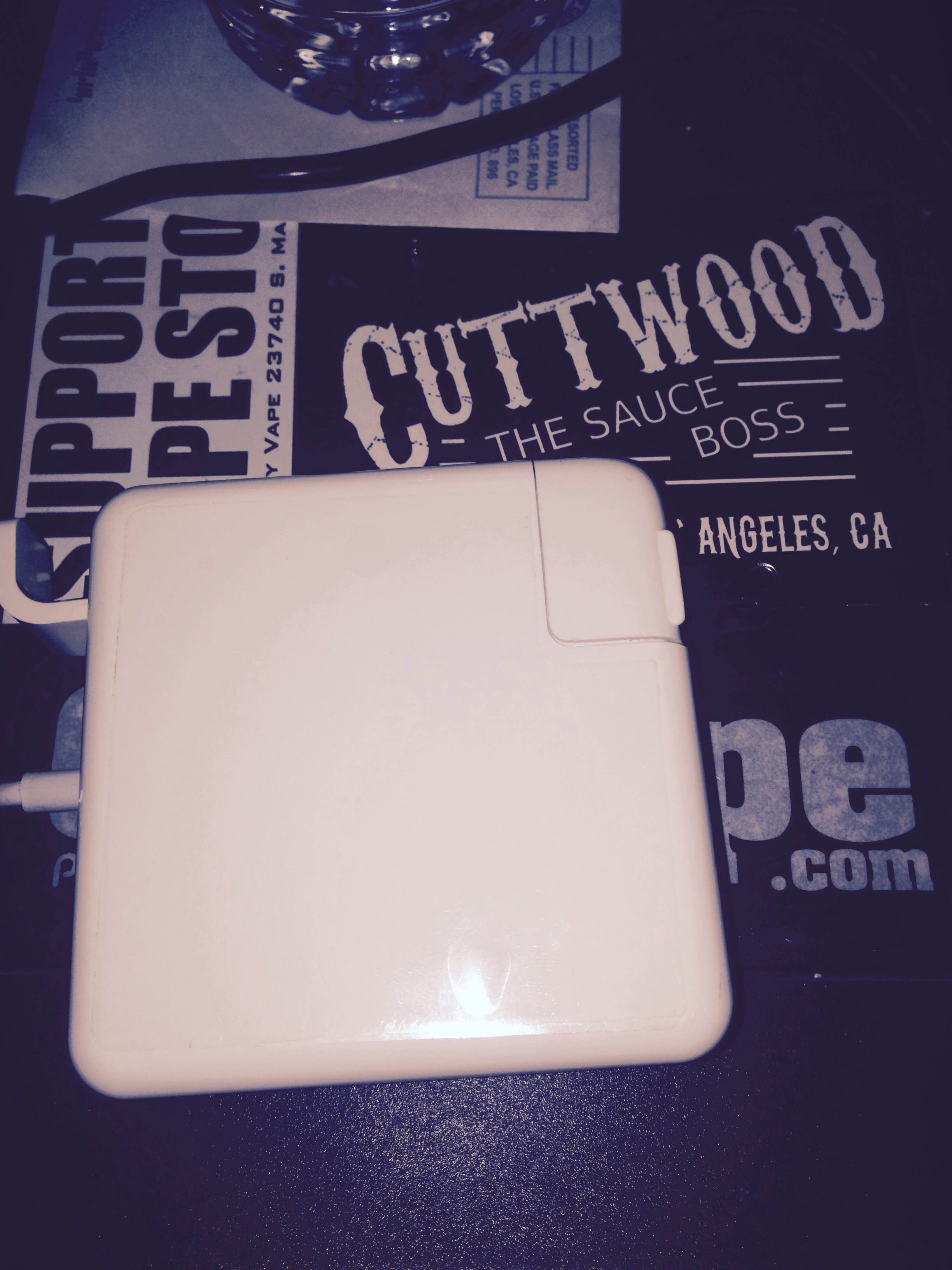

Yes "it" was the laptop turning off. When I kept trying to turn in on and nothing then when it finally did load up (which was how I got the pics I sent) I moved the laptop around and everything and it didnt turn off so idk why it was turning off in the beginning. The magsafe is all one piece im assuming. Ill load some pics of it and I will try it without the battery as well see if that helps it out
[doublepost=1461206273][/doublepost]
Your pictures don't show the piece that may be the easiest to miss. That's the row of matching contacts on the internal port.
Your power adapter is a newer replacement. The original one has a "T" connector, rather than a right-angled one. I also have that newer connector. It's easy to move and lose the connection (losing power), because the cable is easy to accidentally snag, and it pulls off really easy.
I usually turn the plug on mine so the connector wire travels along the side, instead of hanging off the back corner. I have fewer accidental "power-outs" when the adapter wire follows the left side panel.
