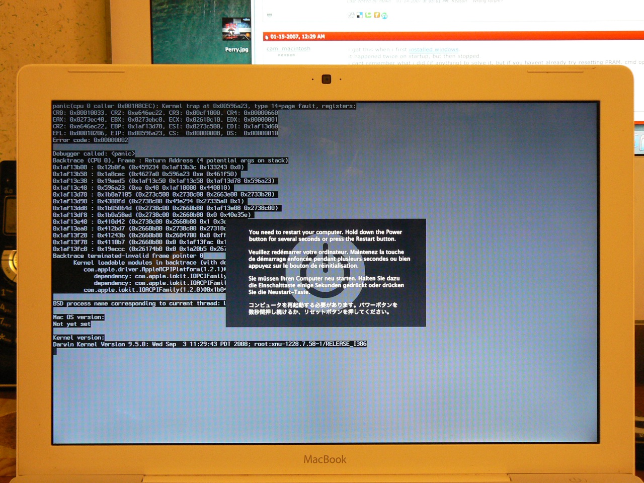

The thread title pretty much sums it all up, my friend is getting a kernel panic whenever she turns on her MacBook.
We've tried starting the OS X partition, the Windows XP partition, and loading the system discs but all three result in the same problem. The only "solution" I've tried is resetting the PRAM and that didn't work.
I've attached a screen of the message.

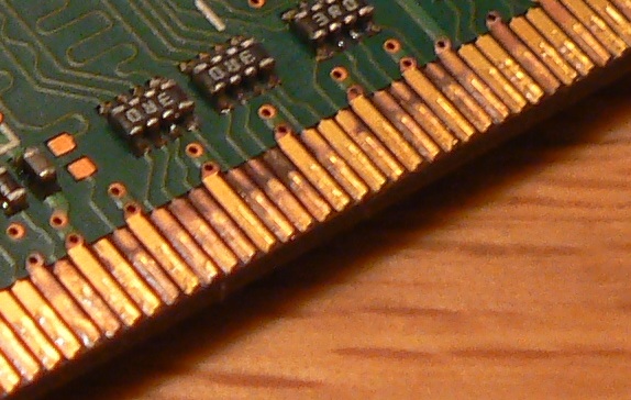

So it ended up being the RAM! What happened, was when she spilled cough syrup on the keyboard a while back, it seeped in around one of the RAM modules, eventually causing it to fail. I took it apart, cleaned it thoroughly, and singled out the bad RAM. Being that the system only has 512MB of RAM now it can barely run, so I'm going to have to buy some more and was looking at purchasing this but wanted to be absolutely sure it would work.

I saw the photo and immediately thought of this thread:
https://forums.macrumors.com/threads/468479/
but that's an iBook, not a Macbook.
😀 It's not really that discolored or anything, but the white MacBook, iMac, and wall in the background took on sort of a yellow hue when I focused the camera directly on the screen. Her MacBook was pretty filthy when she brought it to me, but a Mr Clean Magic Eraser got it all off and if not for all the scratches, it'd look brand new 😛

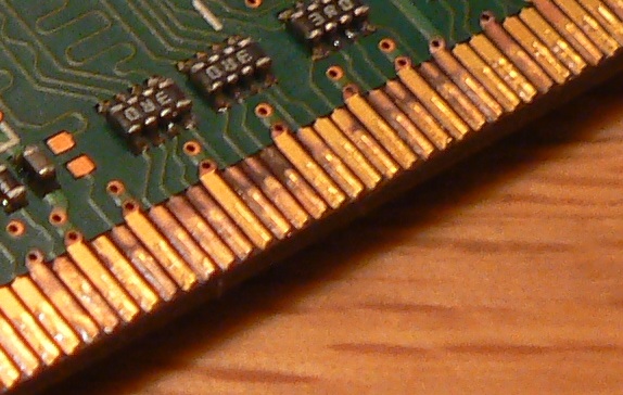

Here's a picture of the damaged RAM module, you can see how the cherry NyQuil dyed some of the pins red:
