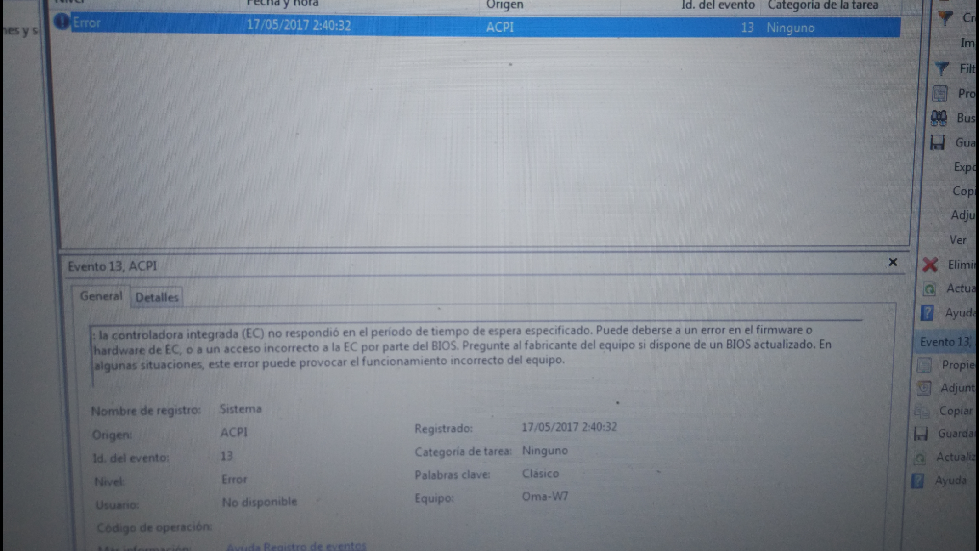

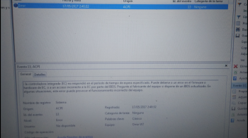

Thanks for your answer, I think Is the firmware or a problem in a component because the windows error log says that there is a problem I have also the log of the MacOs I will post it later. Here I attach the windows 7 error. Later I will upload the MacOs log.
But the problem is that I do not know how to reinstall o downgrade the efi and smc firmware

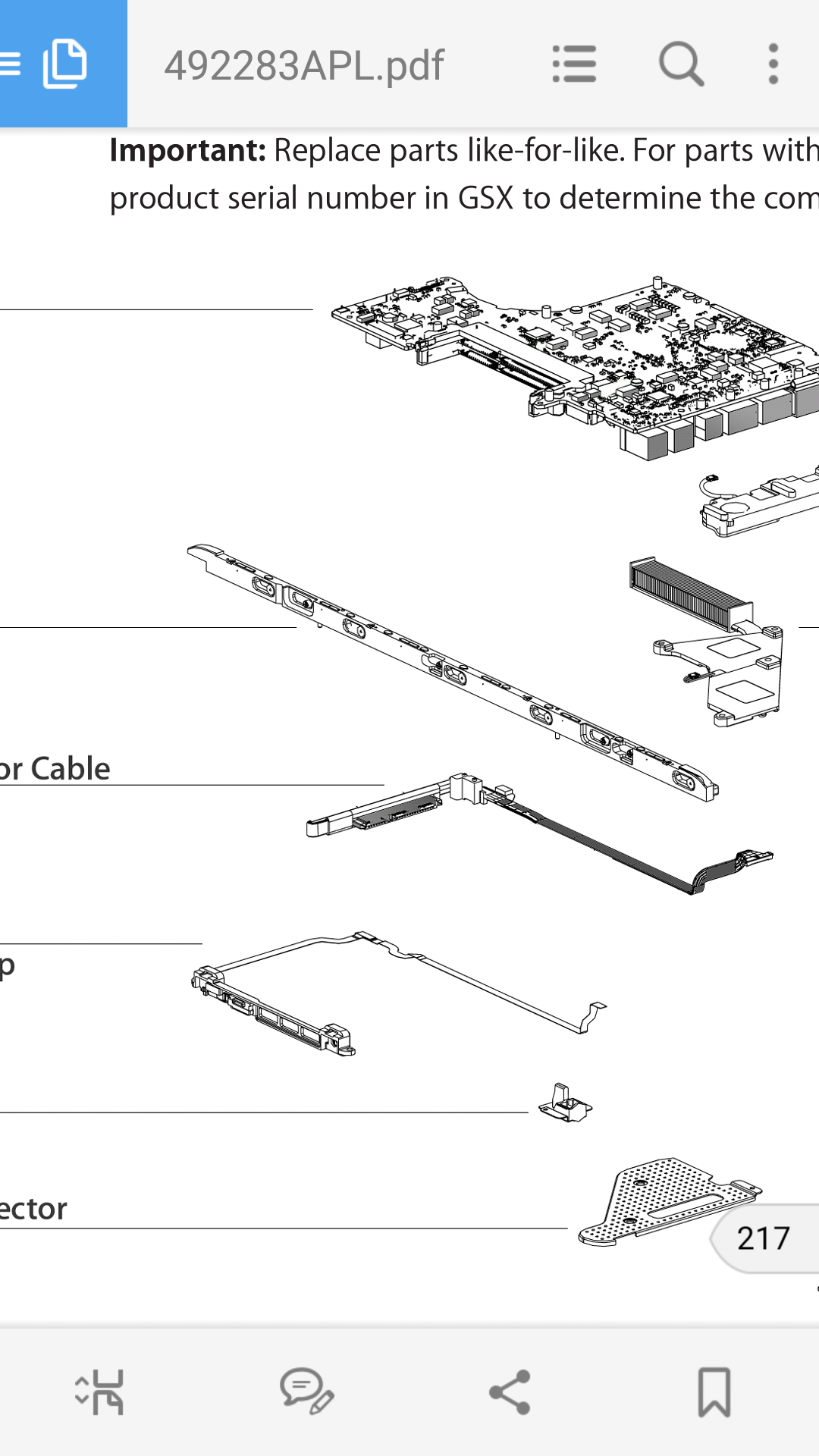

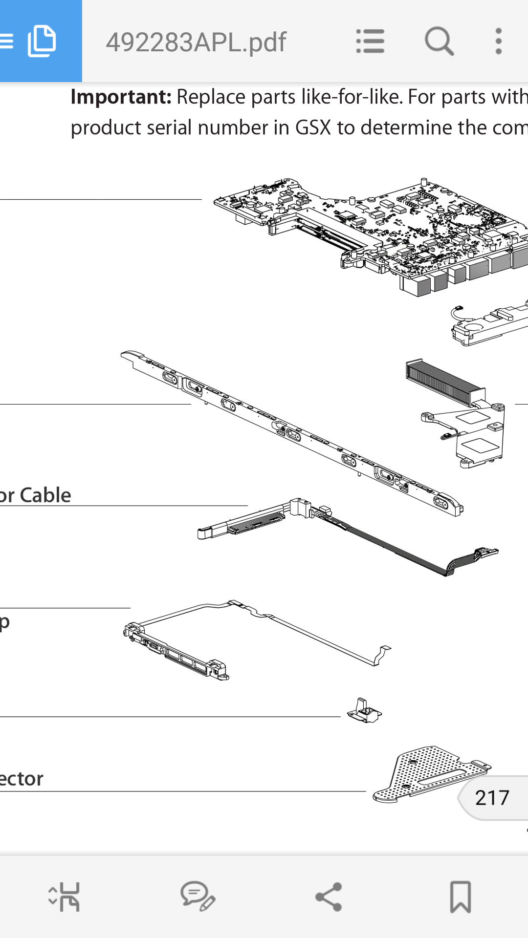

Hello again and thank you for your answers.
Finally I find out what the problem is.
It has damaged the sleep sensor (or stucked) . The one under the hard disk . The Ir/ sleep sensor. I unplugged it from the logic board. And it works great. I asked one to replace it and let you know.
