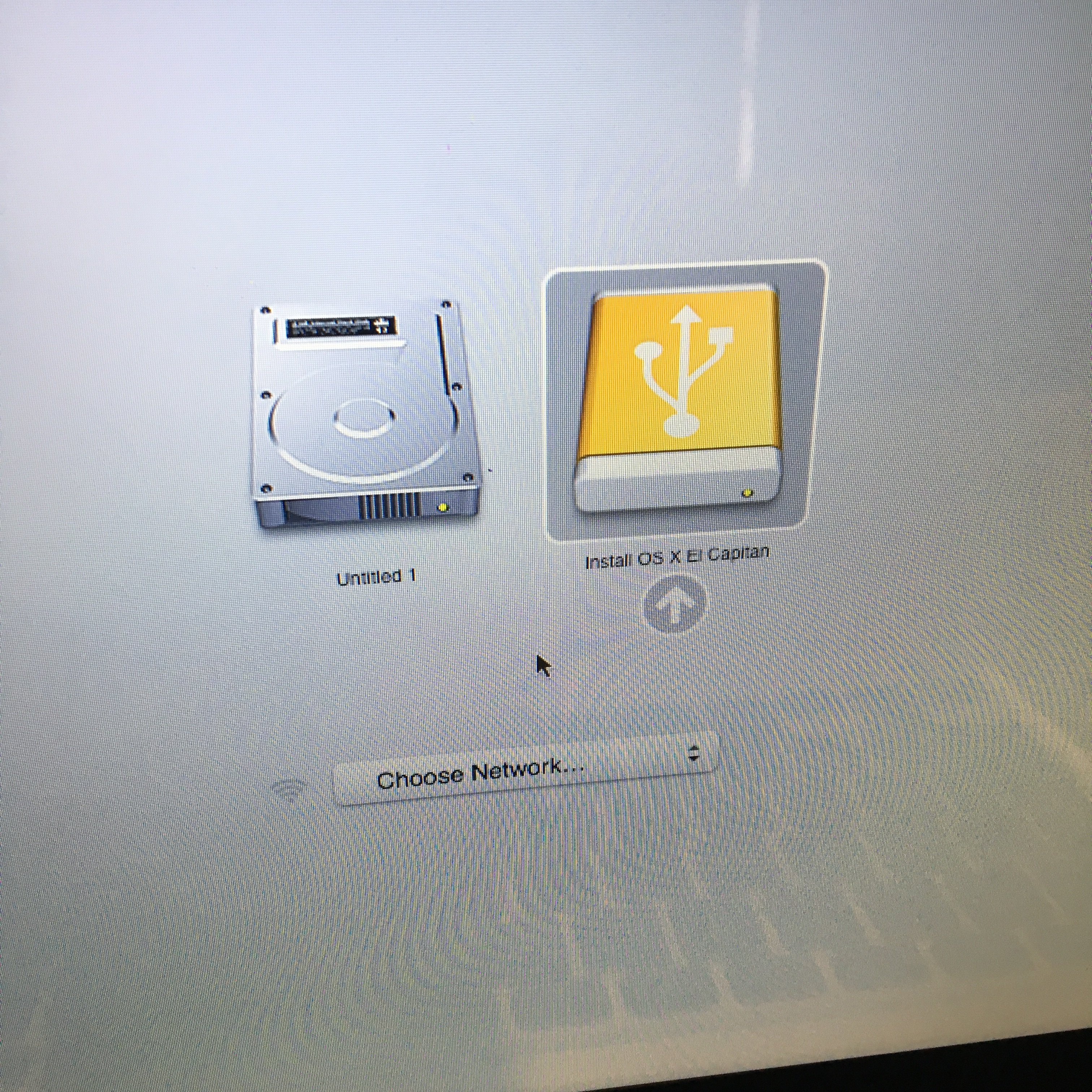

Yes, the Bootable USB does appear in Disk Utility.
However, there is no Option under Startup Disk (via the Apple Menu) to boot the USB from there.

Cheers DeltaMac, and yes I’ve tried this previously about 10 times using a secondary keyboard and it doesn’t chime twice. It just loads up the 4 Options as per usual. Any idea why this is?
If you don't have any bootable "thing", either internal, or external, then even if the boot picker screen appears, it will correctly be blank (nothing to boot)

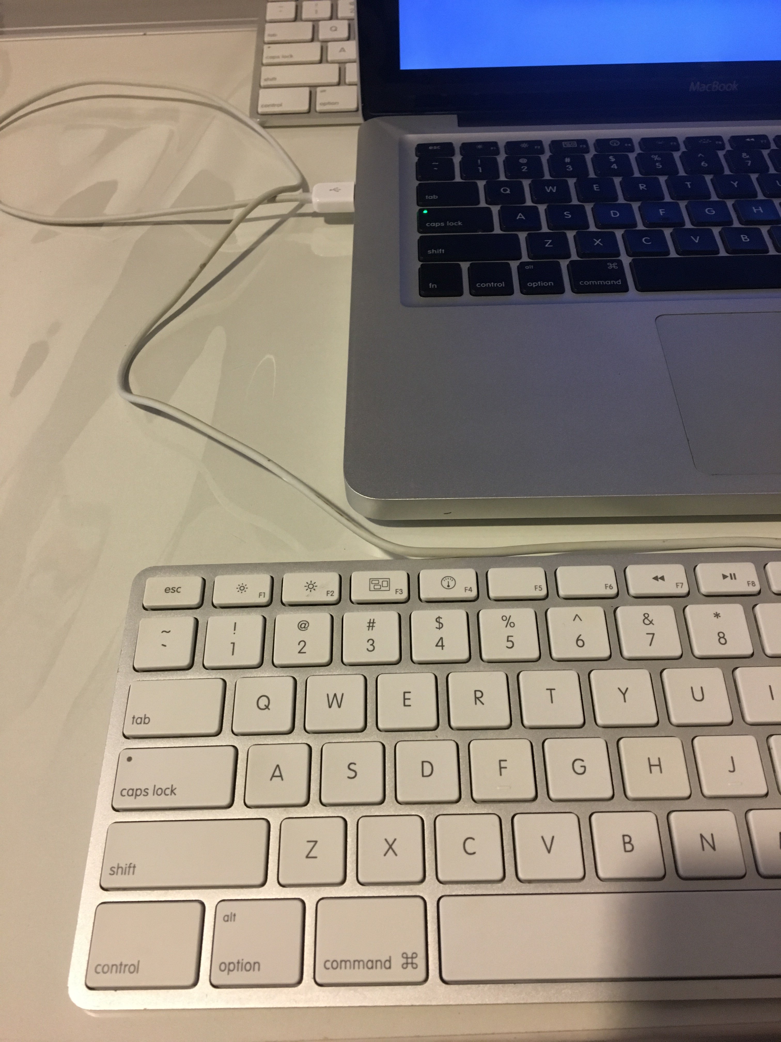

Yeah this Macbook’s has to be FUBAR I’m running a secondary external Apple keyboard, and I know it works because when I type with it (in Disk Utility for instance) it’s in lowercase as it should be whereas the MacBook is all CAPLOCK and I have to hold 4 buttons (fn, control, option and command) before the numbers work otherwise they type #%^* etc.

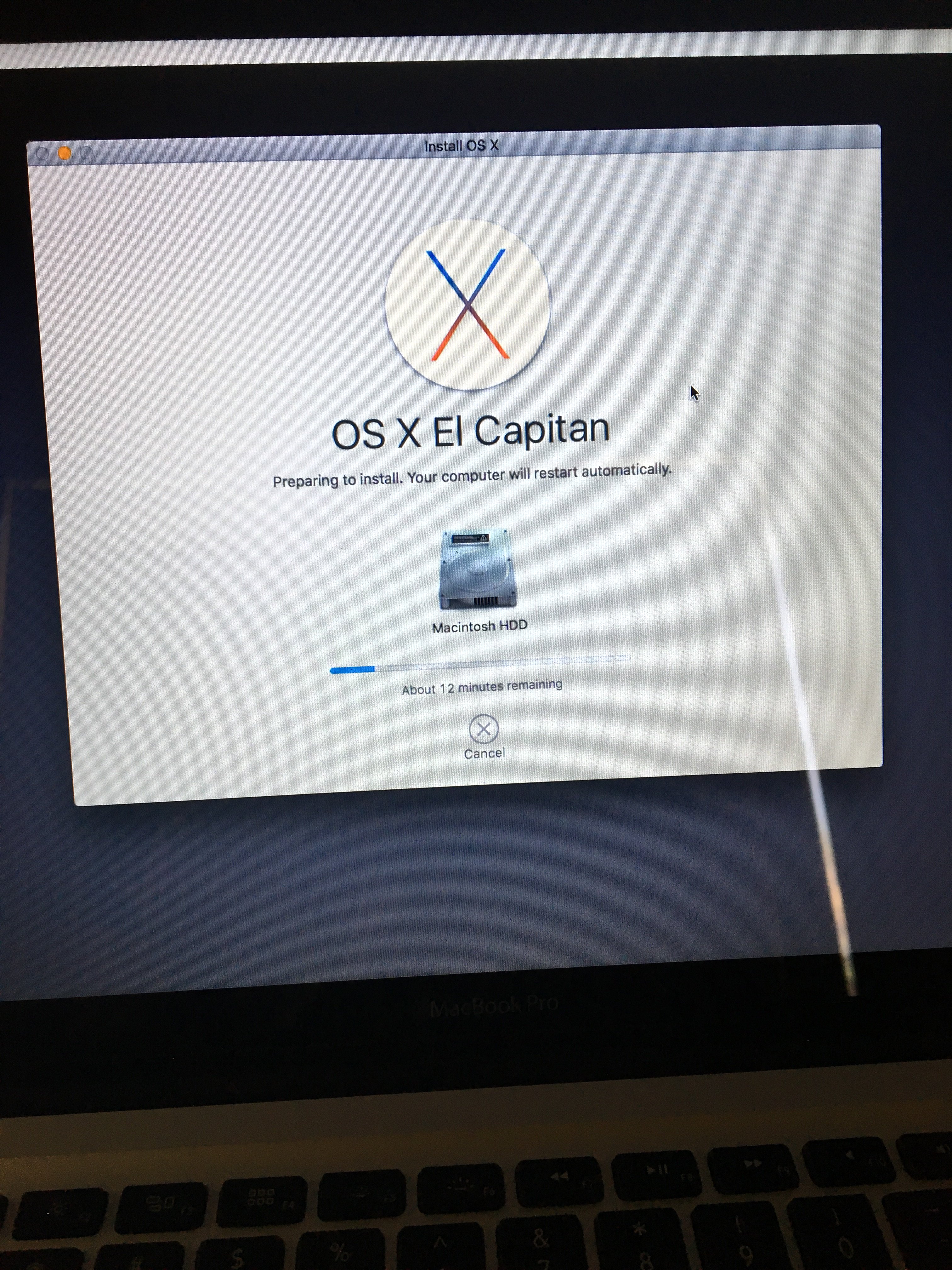

[doublepost=1561949274][/doublepost]P.s. I just acquired a second MacBook to check my Bootable USB works and look:
So the problem isn’t the fact there’s something wrong with my Bootable USB, it’s got to be the 2008 Macbook not loading Startup Manager for some weird unknown reason...
P.s. Startup Disk on this new MacBook doesn’t show the Bootable USB either so you can’t USB boot from there irregardless but thanks for the suggestion.
So, caps lock is stuck? I think that's part of your problem for the boot key commands, as the keyboard doesn't know what to do with that stuck key during boot. It wouldn't affect your good external keyboard - but, you may have OTHER stuck keys.
But, now you have another install solution:
Put your new SSD in an external enclosure. Connect to your new MacBook. Install El Capitan (the ultimate test for your bootable USB installer 😎 ). When you can successfully boot to that SSD on your "new" MacBook, now, swap the SSD for the HDD in your aluminum 2008. Just let it boot up. Should go to your newly setup system.
If it continues to boot to the recovery system (the Utilities window would indicate that, instead of the usual desktop with a dock), NOW go to that Startup Disk in the Apple menu. Select the SSD.
And, restart. SHOULD boot to the SSD normally now.

Ha! I hadn’t even read your reply until just then but I already thought of it and I’m currently midway doing this - only with the old HDD.
Just took the old HDD and swapped it out of the 2008 MacBook, and put it in the second MacBook, held the Option Key down and used my WORKING Bootable USB and guess what?!
Check it out:
I’ll let you know how it goes and yeah I’m with you thinking it’s a bum keyboard on the old 2008 MacBook.

  3. Change your password to one that uses all caps and no numbers
  4. Download and install KeyRemap4MacBook.
  5. In the “Misc” section of Karabiner-Elements aka KeyRemp4Macbook there’s an option under “System Default Configuration that you can click ‘Copy the current configuration to the system default configuration.’
All I have to do each Startup is hold down the Option key until the Apple logo is shown to ensure it doesn’t boot into Safe Mode by default.
Problem fixed!
Issue: left shift key is stuffed, hence why everything is in CAPS as the caplock key is always on / capslock key is stuck (even if the CAPS light is off) AND the numbers are showing up as symbols. This also explains why the PRAM couldn’t be reset AND why it didn’t load up Startup Manager when the Option key was held down - BECAUSE BEHIND THE SCENES THE LEFT SHIFT WAS BEING HELD DOWN THE WHOLE TIME DUE TO IT BEING INVISIBLEY ‘STUCK’ (could have been some water damage from the previous owner like in that website link).
Full Link: https://apple.stackexchange.com/questions/36636/how-can-i-disable-safe-boot-or-the-shift-key
