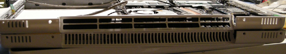

If you check the back of the casing you will see 5 large rectangular vents (about 4cm x 2cm) if it is a Santa Rosa model - previous ones have a grill with hundreds of vertical vents all the same...)
The earlier logicboards will "fit" in the SR case but the heatsink does not fit and you will need new speakers, bluetooth, heatsink/fan etc

count them again - there are 5 🙂🙂🙂🙂🙂

Santa Rosa bottom case is the top one - the earlier bottom case is underneath - there are either 5 (double) vents or 10 vents
