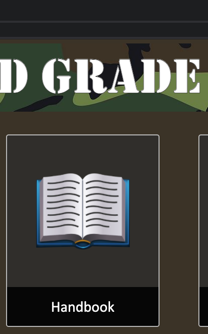

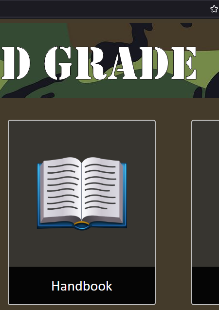

At work, I now use a 2-way HDMI switcher to connect both our Windows 10 PC and my MacBook Air to one 32" 1080p display and I switch between them using the button the switcher. For some reason, my Windows 10 PC looks nice and crisp on the display, but the MacBook's output looks awful in comparison. Both computers are set to output the max resolution of the display (1920x1080), so how is this possible? They are both connected using the exact same brand of HDMI cable and I even tried two different HDMI to USB-C adapters (the Apple multi-port adapter and an Anker single-port adapter) with the MacBook (Windows tower has HDMI port). I mean, just look at the difference in the following two screenshots:
Windows 10.......................................MacBook Air
Also, I tried connecting the MacBook directly to the display, but the quality is the same (poor).

As you can see from my screenshots, the Windows computer looks nice and sharp on the display. The Mac looks like someone knocked the focus ring of a projector off a bit.

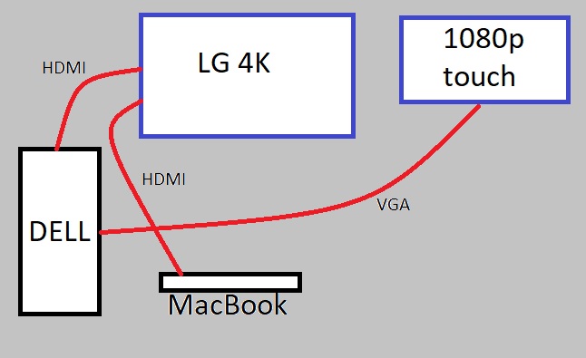

I see your edit, but let me just be sure I'm clear for you and anyone else reading this. This is the setup I wanted:
And the issue is if that 1080 touch display is connected to the Dell in mirrored mode (which I need it to be), then that automatically reduces the LG 4K to 1080p as well (with no option for higher resolutions) - and for some reason 1080p looks atrocious on the LG and is locked to 30Hz, even though it looks great on the Dell 1080p display and the Dell display supports 60Hz @ 1080p. So I've replaced the LG 4k back with the Dell 1080p and am using the LG 4k exclusively with the MacBook now. I didn't want to have two displays cluttering up the desk, but that's my only option at this point unless I shell out more money for a 4k touch display.

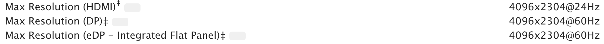

UHD 630 can do "4K" at 60 Hz just fine - but only via DisplayPort, not via HDMI.
Your link is to a page on an i7 processor. In any case:
1. I don't get that limitation.
2. The Inspiron 3880 doesn't have DisplayPort.
So basically, Dell designed a computer that's pretty much useless with 4k displays at their max resolution (unless someone wants to get dizzy watching stuttering lag all day @ 30Hz).
...which has UHD 630. The page also lists the maximum resolutions attainable via DisplayPort and HDMI. These apply to all processors with UHD 630.
(I accidentally linked to an i7 that has the older HD 630 - sorry! -, but UHD 630 is still subject to the same limitation.)
It's because of HDMI 1.4. HDMI 2.0 is necessary for "4K" at 60 Hz via HDMI.
Indeed, and the manual confirms it only has HDMI 1.4. Big screwup by Dell there.
