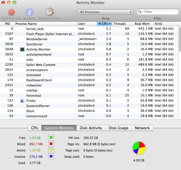

here you go, thanks for responding so quickly, there are multiple processes running and i don't know what the majority of them are, they don't seem to be taking up any CPU%, should i scroll down and post those as well or is this sufficient?
All is well there, this is not your problem.

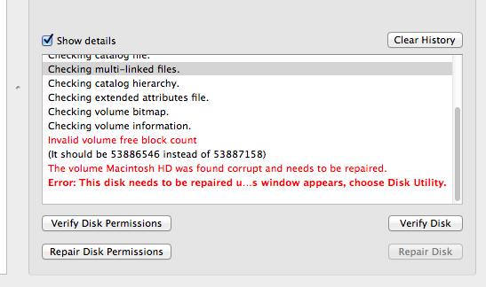

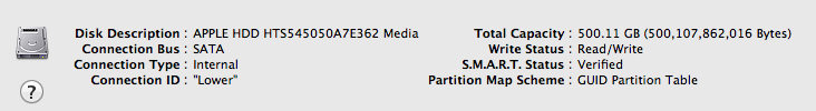

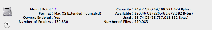

the HD didn't have the S.M.A.R.T status but the one above it did, i took a screen shot of both just incase
EDIT: i verified the Hitachi disk and it says everything is ok, the Macintosh HD took longer to verify, it says it needs to be repaired, i'll post a screenshot, i've tried to repair it in the past and there was one thing that it couldn't fix, should i try again?
It's the second screenshot, the other one is the Volume, not the HD, but that one is also OK.

Now, plenty of red parts, it needs to be repaired.
What I meant:
A HD can not be repaired if you are starting up from that HD, it needs to be unmounted but it can't because it is in use.
The only way you can repair this is starting up from another external source, this can be the OS X DVD Installer if you have one, or a copy of your HD if you made one before, like a backup.
With newer Macs Recovery HD is built in, this means when you need to repair the HD you can do so by holding the D key at startup, but, I think yours did not come with this.
Oh, I just had a look, you have 10.7 installed, you might just have Recovery HD.
Try holding the D key at startup, if this works you get to a Utilities screen, from the menu open Disk Utility and try to repair your Mac.

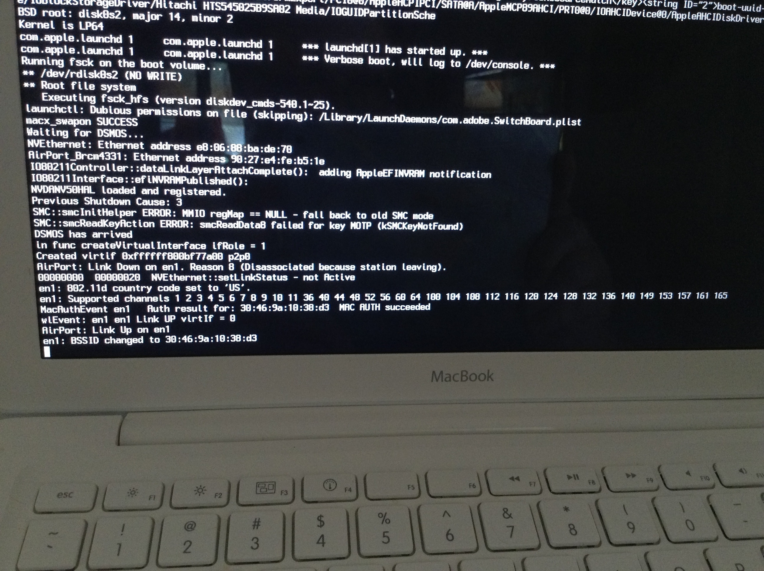

when I startup in verbose mode the log is getting hung up on
"launchctl : dubious permissions on file (skipping) : /library/launchdaemons/com.adobe.switchboard.plist"
I'm taking pictures of the entire log as it lodes with my iPad, let me know if you need to see that
EDIT: here's the photo I took, there were a few more errors below so I thought I better add it

Where did it hang, where the cursor is in your photo?
Did it stop for a while while doing fsck, also in your screenshot.

the only major hang was the launchctl part that i bolded in my post, there where a few 1 - 5 minute pauses after that but the first hang i mentioned was close to 20 minutes
