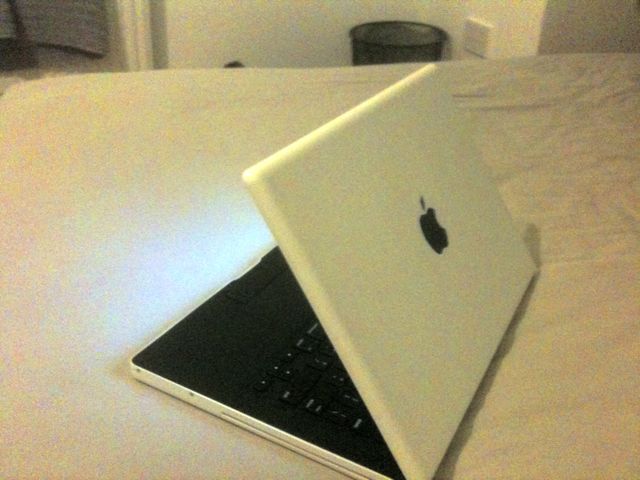

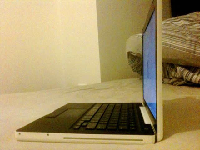

Hey guys,
So I finally got around to modding my macbook, here are the results.
I know its not to everyones taste but I love it! Sorry about the poor picture quality, iPhone camera 🙁
