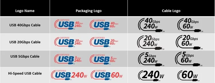

Certified USB-C cables are required to carry a logo on the connector. If you buy a cheap non-USB-IF certified cable, that's up to you. Apple being Apple never has a logo and you have trust them.

the AI lied to me! it said that higher charging speed is only achieved because the data transfer component is taken out of the cable. my mistake!
nice to know. So Apple cables are not USB-IF certified? because if they are, then this certification is worthless as labeling the connector is optional.
The labeling is not required for compliance certification. It’s always been optional because every company that makes cables are members of the USB-IF. In many cases, the same company’s making the same cable for a lot of different companies. Those cable makers want to be able to provide cheap solutions for some of their customers while providing high dollar solutions for Apple and others. If cables were labeled, users would be able to easily tell the difference and the cheap cables wouldn’t sell as well. So, of course, those members of the USB-IF that have an interest in the consumer not knowing, always vote to make labeling voluntary.
Of course it's required. That's the whole point of the logos because logos represent certification. It would be like saying CE logo is not required for compliance. You have it completely backwards. The companies who pay to be part of USB-IF want a trademarked logo to separate themselves from non-members.
"In order to pass through the USB-IF Compliance Program, all USB-C® to USB-C cables categories must be labelled with either a power capability of 60W or 240W by using the appropriate power icon and/or logo. The USB-IF now requires that all cables must be labeled with the 60W or 240W logo prior to compliance testing so that testing can confirm the intended display of such icons/logos. The policy now extends to all USB-C to USB-C cables. These markings must be checked before compliance testing can begin."
