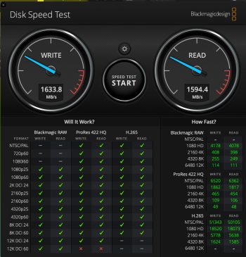

512gb version. I get an average of 15.5 read & write. The photo is the best try. Never came close to 1700.
I'm surprised the 512GB is slower than my 256GB M1 Air. I assumed SSDs increase with higher SSD capacity (or rather more SSD modules). Must be using slower SSDs for the Neo.

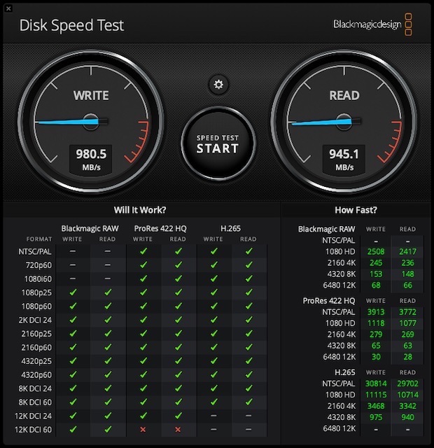

The Neo read/write speed is on par with the Crucial P510 Gen 4 NVME drive in a Terra Master D4-SSD DAS and a bit faster that the Crucial P310 Gen 4 NVME drives in the D4. I have the D4 connected to my Mac mini using Thunderbolt 4.
For giggles I tested a Kingston NV2 1TB NVME in a SSK USB Gen 3.2 NVME enclosure plugged into the Neo's USBc 3 port. It didn't do too bad.

Have you tried other drives in the USB 3 port? Is 1000 the max speed any drive will do in the USB 3 C port?
I haven't tried any other drives since all of my faster drives are either in my DAS or installed in my Minisforum BD895I build. I'm too lazy to remove disks from either one.
I plugged the drive into the front USBc port on my M4 Mac mini and got the same read/write speeds. I then plugged it into a Thunderbolt 4 port and got the same write speed but a slower read speed of 750 MB/s
I would say the limiting factor in my case is the SSK enclosure , at least when testing on the M4 Mac mini. I don't have a single disk Thunderbolt 4 enclosure to test.
1000MB/sec is close to the max one is going to get through any 10Gbps USB port. The best I've measured through one on any computer is about 1050. There might be a few combinations that peak slightly higher but I wouldn't worry about it.
If one needs to go faster than that, Thunderbolt/USB4 is the way to go.
