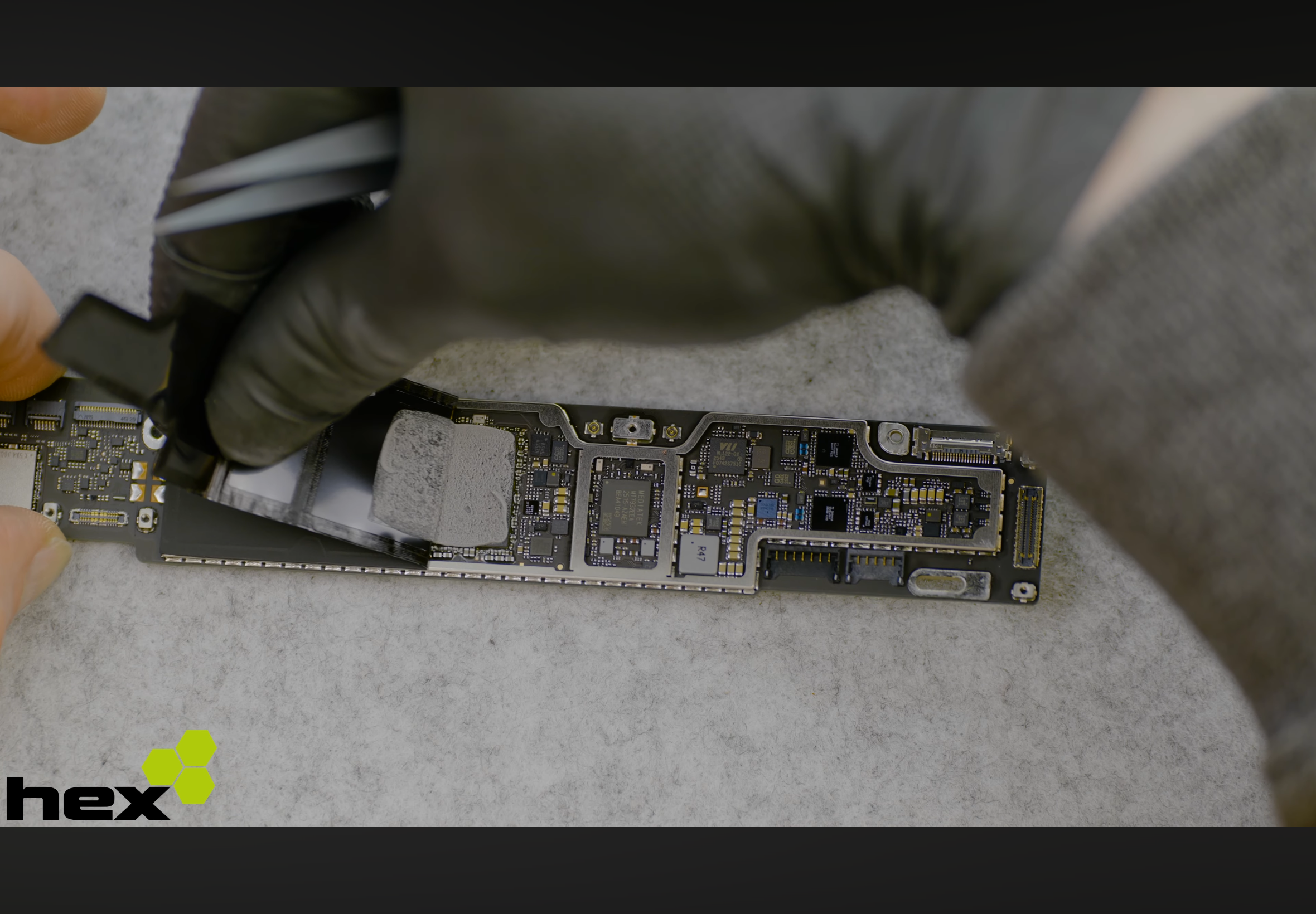

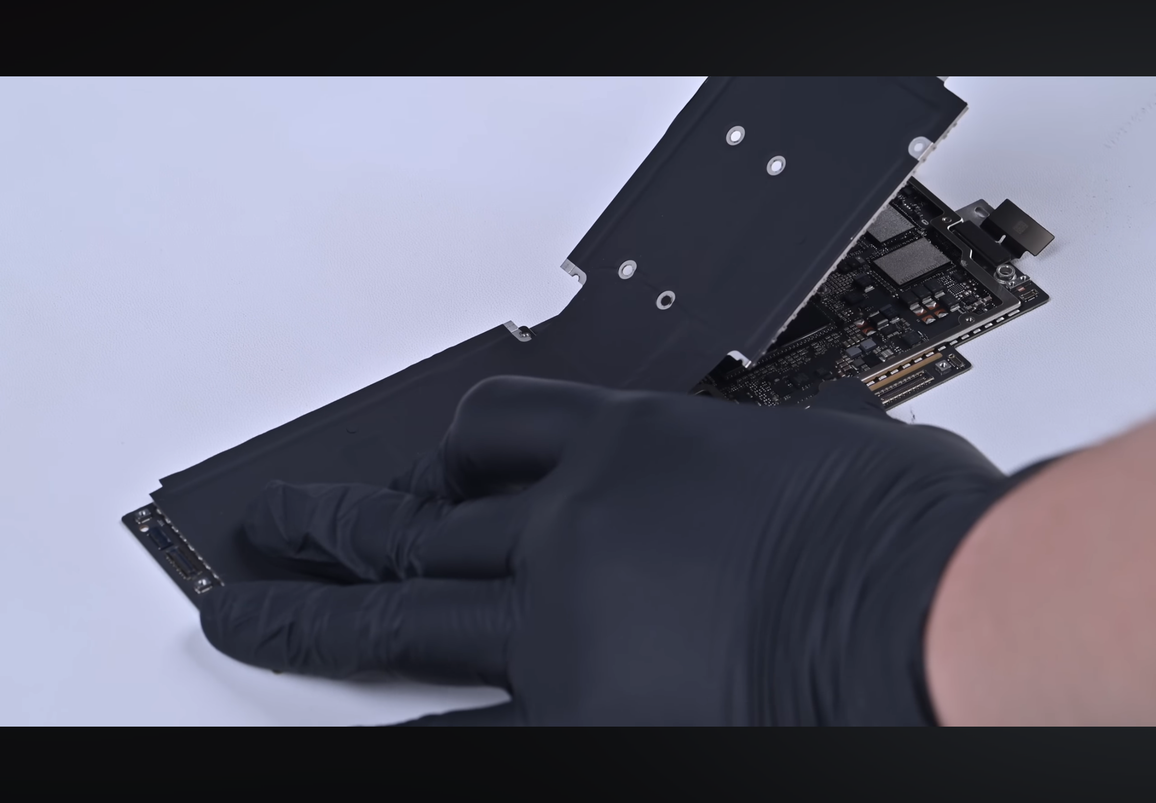

Looks like Neo uses only a graphene pad as a heatspreader. Although expected, still slightly disappointing since it limits sustained performance.
How does that compare to what was used in the iPhone 16 Pro? And would it be possible to replace it with a heat spreader made from something else?
iPhone 16 Pro uses a thin metal heat spreader in conjunction with graphene. Same with MacBook Air M2-M4 and iPad mini A17 Pro.
Apple sells thermal dissipation performance as a feature, so it's not surprising, just disappointing they really did it.

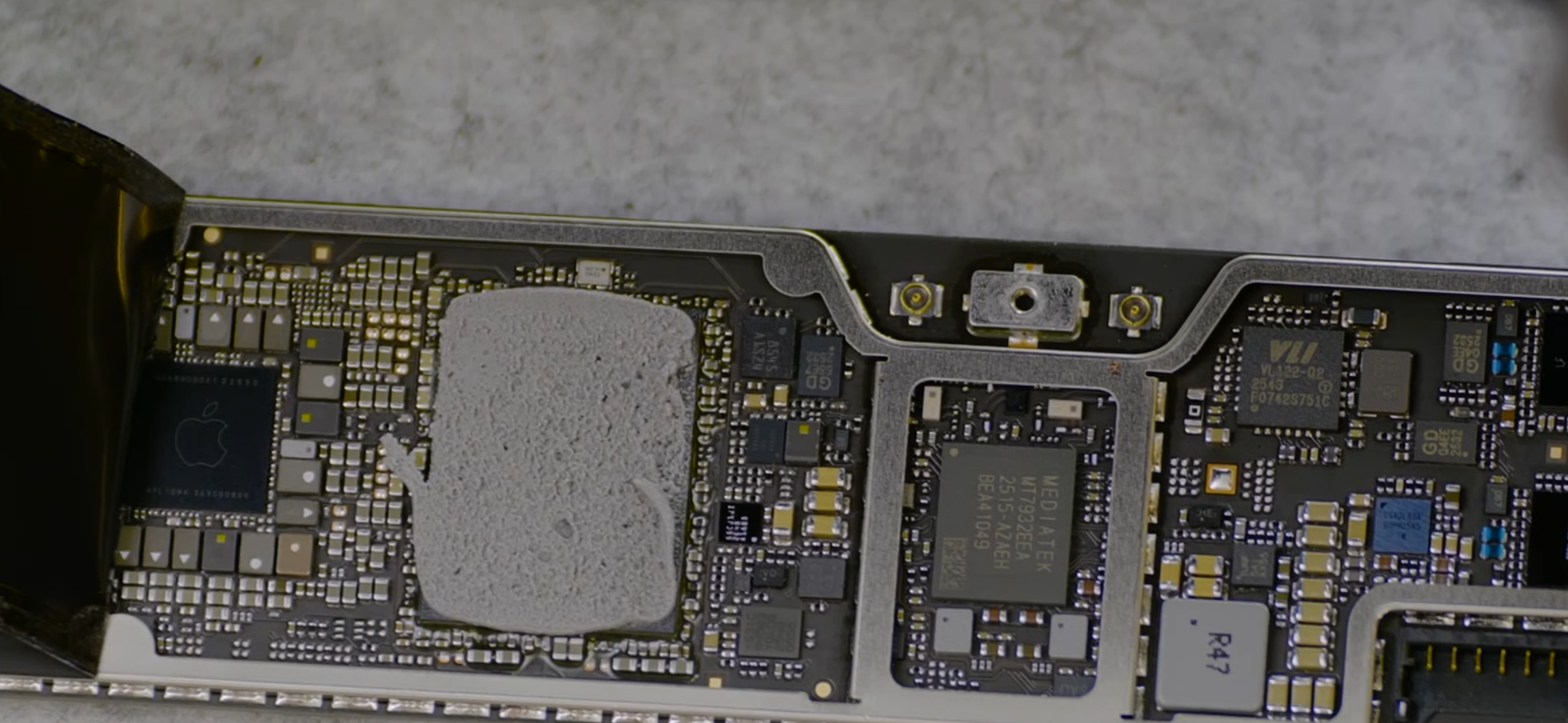

VLI VL122 4-port USB 2.0 Hub controller from VIA Labs.
Apple engineers probably miffed they had to go back to a third party controller when the SoC already has one. But marketing said they needed a second port.
Is it effectively a built-in USB hub? Or something more complicated?
It’s a standard USB 2.0 hub. The only thing complicated was Apple needed to get USB-PD on the additional port because the chip doesn’t support it.
